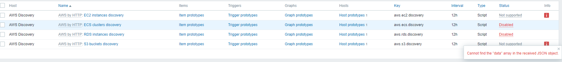

    Hi to all! I'm trying to monitorize my AWS infra from my Zabbix Server 6.4.5.
    I'm using the official templates for 6.4.5 , the template aws_http
    I follow all the steps:
    1. Create the IAM policie
    2. Create the user and assign iam policie
    3. Create access key for the user
    4. Create host and:
      1. assign template aws_http
      2. assign group
      3. configure 3 macros: {$AWS.ACCESS.KEY.ID}, {$AWS.SECRET.ACCESS.KEY}, {$AWS.REGION} for the host
    5. Then I enable in the host --> discovey rules:
      1. EC2 instances discovey
      2. S3 buckets discovery
    6. Then i recieve the error in both discovery rules: Cannot find the "data" array in the received JSON object​
    Any help?
    Thanks!

      Thanks, but zabbix_server.log not show any log about this host (errors, warning, etc)

            Hi to all and thanks for your help. Now only EC2 discovery are ok
            I describe my path to solution...
            1. I try to up the level log to 4, and see a lot of info about EC2 discovery but zero log from S3 discovery
            2. I think cyber and bigsmooth is on right, the script fails and give a error, but with debug log = 4 no print info about that
            3. Then i see that there is a new version of template, and download and import this new version for Zabbix 6.4.7
            4. I retry all the process describe in the first point and... .voala! I see all info about EC2 but not S3 services
            PD: from past version, in the new version there is a new macro named "{$AWS.AUTH_TYPE}" for config access_key or role_based (I use access_key)
            I try to research... but for me it's to hard to modify the javascript​
