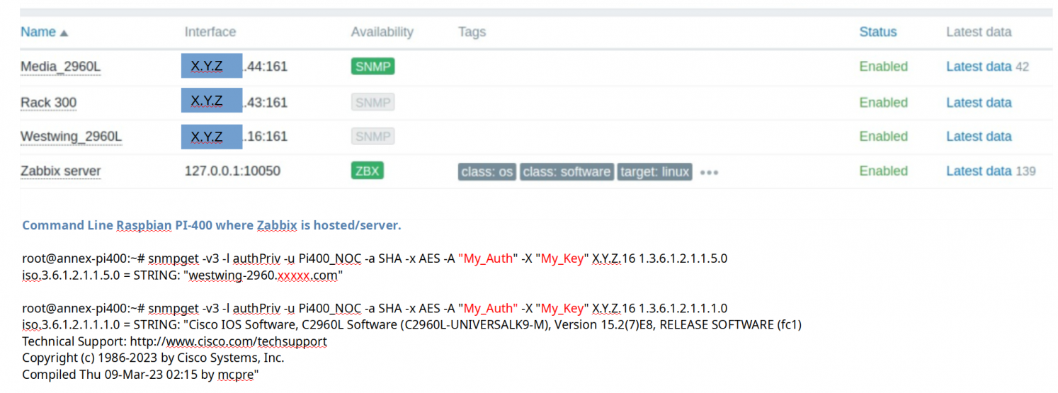

      • sentinel_watcher
        • Aug 2023
        Thanks for thoughts, have tripled checked teh Authentication & Privacy algorithms and values multiple times.....all match exactly for hosts and Zabbix server. Interestingly your suggestion of blanking/deleting the Context name works and one of the hosts, suddenly went GREEN for SNMP info and values could be seen. I therefore repeated for other hosts but they stayed gray, even a "Clone" of working host did not return any further info. SO I have one working 2960L but Zabbix does not seem to sending SNMP requests to any of the other devices now. I used Cisco debug SNMP packet and requests on switches to see if anything was being sent by Zabbix. sadly debug stayed quiet until I manually used CLI SNMPget to same network device ( .16) ...see debug output.
