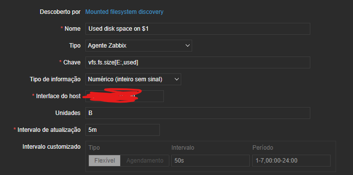

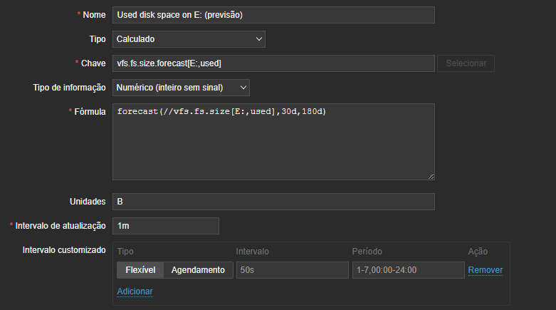

I'm trying to forecast the usage of a disk with currently 13TB used, but the value shown is always limited to 931.32GB. When I try to forecast the usage on disks with less than 1TB of use, the function works perfectly.
I've read that zabbix can't process values bigger than 999999999999.9999, but isn't there any solution so I can show the values correctly?
Here are some screenshots of the forecast item, the item i'm trying to forecast and the forecast value shown.
