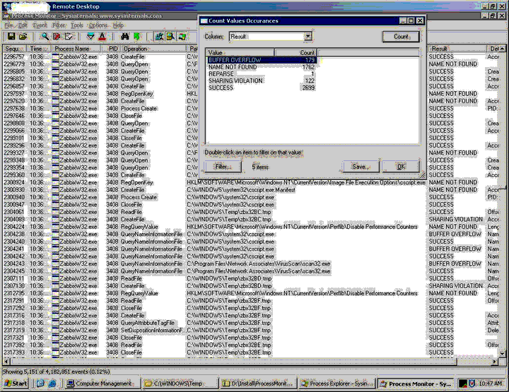

                I grabbed the sysinternals process monitor and saw the following:
                I see a lot of BUFFER OVERFLOWS and SHARING VIOLATIONS.

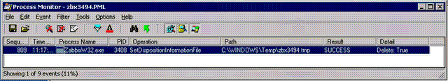

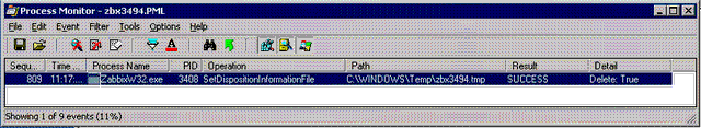

                Furthermore I checked the diffrences between a file that got deleted and a file that did not get deleted.
                The file that got deleted had the following succeded operation:
                The file that did not get deleted did not have an operation like that, not even in failed state. It did however get a lot of requests from explorer.exe and the AV scanner. I put these files in the exclusion of the AV scanner, but it doesn't seem to have much effect. If needed I can supply .PML files for a further insight (although they can be rather large).
