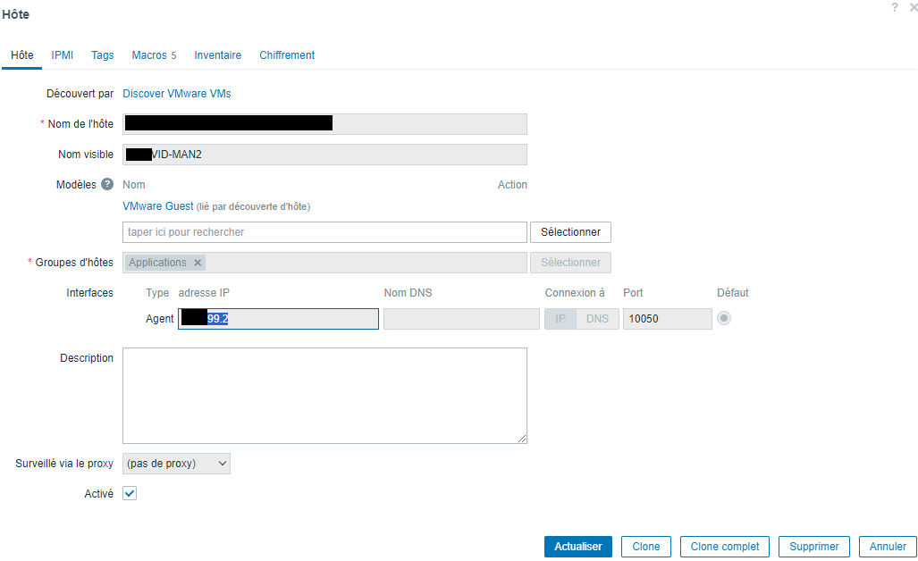

    In our project we have 2 ESXi hypervisors with some VMs on them and I have installed the VMWare integration on my Zabbix server. I've configured the hypervisors hosts to detect all the VMs present and it works perfectly.
    However i have 1 problem with 1 VM. It looks like the integration select the very first IP address in the general informations about the VM, but this IP address is a "cluster address" and it is not possible for me to interract with it. The zabbix agent and server cannot communicate with each other neither.
    This is not a network problem, I just want the selected ip address to be X.X.8.22 but the field is grayed out and I can't change it. I know I can create the host on my own, but I wonder if we can trick it? Let me know what you think.
    Personally, I believe it is linked to the order of the network cards directly on the machine, but I wonder if there's a hidden option in the VMWare integration (because i can fix it on windows but this is not why i make this topic).
    Thanks for your time and here are a few screenshots to illustrate what I'm saying, have a nice day!

    I am facing the same issue, i tried some modifications on vmware tools but with no results. If you find a solution please let us know

      Is your network IPv6 enabled? If not then make it disable in ESXi network. It will solve your issue.​

        No it does not, as you see first v4 address is taken (...99.2), no v6 address is used...
        But how to solve your issue I do not know...

          Yes I know but I'm asking about ESXi network not for Windows host.

            But it is irrelevant.. As you see from pics, vmware discovery chooses the first ipv4 address (nr 2 in list) in that list to be used, but "should" use second one (nr 4 in list) ... and nothing changes if your ESX is v6 enabled or not... You might lose those 2 ipv6 addresses from list, but it still wont move that needed IP to the top of list... I am pretty sure, that vmware discovery is not pulling that list, only takes first one... And my gut feeling says, it is ignoring v6 addresses anyway ..
            Unfortunately I have no direct experience with those vmware templates...​
