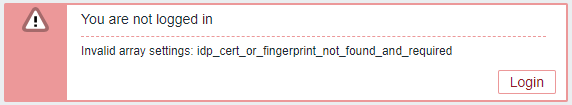

    There has been different errors when I test the connection, the reply adress is http and not https, the reply adress is the lokal IP-adress etc. but the current one is that Zabbix tels me "Invalid array settings: idp_cert_or_fingerprint_not_found_and_required​".

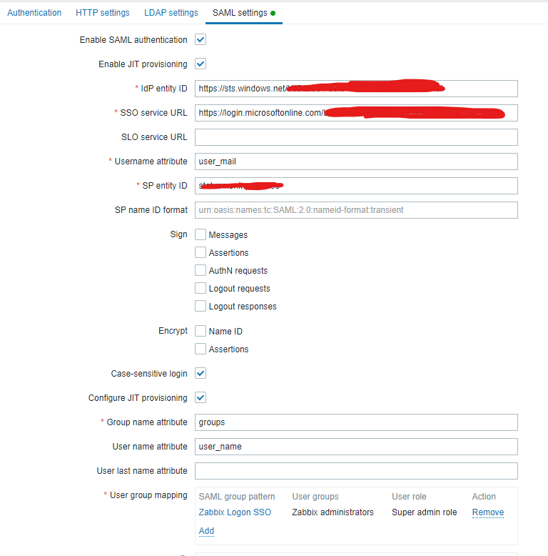

    These are my settings in the frontend

    The cert-file is also placed in /usr/share/zabbix/conf/certs# as ipd.cer and the settings in the zabbix.conf.php i set as
    //$SSO['IDP_CERT'] = 'conf/certs/idp.cer';
    //$SSO['SETTINGS'] = ['use_proxy_headers' => true];

    I am trying to get this working too but I think I got a little further than you, there is something up with the cert being wrong or mis-spelled perhaps in your case.
    • Alexander J
      • Sep 2023
      • 10
      Did you write that exactly as pasted here?
      it should be like this:
      Regards
      • RobinH
        • Jul 2023
        • 55
        Ah, thanks! Did not se the //...

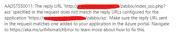

        Now I get a new error when trying. It seems like I get the reply from http an not https, how do I solve this?
        I have set the $SSO['SETTINGS'] = ['use_proxy_headers' => true]; but

        • Alexander J
          • Sep 2023
          • 10
          Are you running behind a proxy?
          If yes, you need to make sure your passing the headers to Zabbix.
          • RobinH
            • Jul 2023
            • 55
            It does'nt work with the configuration $SSO['SETTINGS'] = ['use_proxy_headers' => true];
            Still say the same error...
            • Alexander J
              • Sep 2023
              • 10
              Thats exactly the error I was stuck on, the fix was adding the right headers to the proxy_pass block in Nginx.
              Are you using Nginx also??
              • RobinH
                • Jul 2023
                • 55
                Im using Apache2 for this set up.
                • Alexander J
                  • Sep 2023
                  • 10
                  OK,
                  Here is what solved the problem for me (using nginx as reverse proxy on HA-zabbix cluster)
                  location / {
                  proxy_pass http://zabbix-cluster/;
                  proxy_set_header Authorization $http_authorization;
                  proxy_pass_header Authorization;
                  proxy_set_header Host $host;
                  proxy_set_header X-Real-IP $remote_addr;
                  proxy_set_header X-Forwarded-For $proxy_add_x_forwarded_for;
                  proxy_set_header X-Forwarded-Proto $scheme;
                  It was these header statements that solved the problem.
                  Regards

                    So you added these settings and the local adress for the Zabbix in Zabbix.conf.php?
                    • Alexander J
                      • Sep 2023
                      • 10
                      No, this is the nginx configuration, it will be different for you - You need to do the equivalent in Apache. (Assuming you are using it as reverse proxy, your previous replies indicate that is likely the case)
