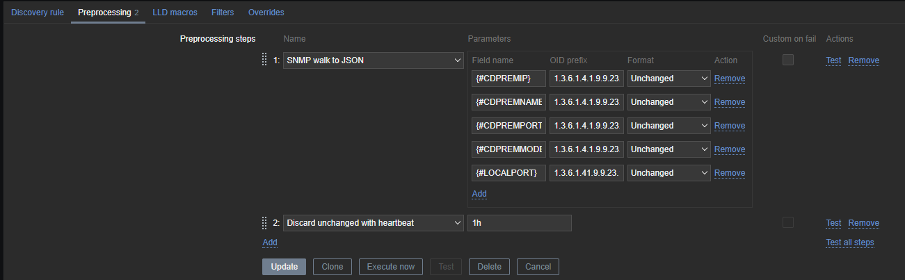

    DISCOVERY RULE (CDP neighbor discovery) that is a dependant item of the item. Preprocessing the step of "SNMP walk to JSON" which extracts the CDP information. In here is where I tried to create the field that links to the OID without the .5

    ITEM PROTOTYPE (CDP Neighbor1 {#SNMPINDEX} connected to {#CDPREMNAME} on {#CDPREMPORT}) - I am using [HASHTAG="t5074"]snmpindex[/HASHTAG] as a check which is returning the 10101.5, but it can never extract the OID information. This has a preprocessing item "SNMP walk value" to a integer within a CDP OID item
    Example OID and data:
    • Local switch port: .1.3.6.1.4.1.9.9.23.1.1.1.1.6.10101 = STRING: "GigabitEthernet1/0/1"
    • Remote Switch IP: .1.3.6.1.4.1.9.9.23.1.2.1.1.4.10101.5 = Hex-STRING: 40 40 40 40
    • Remote Switch Name: .1.3.6.1.4.1.9.9.23.1.2.1.1.6.10101.5 = STRING: "REMOTE-SWITCH-SW064"
    • Remote Switch Port: .1.3.6.1.4.1.9.9.23.1.2.1.1.7.10101.5 = STRING: "GigabitEthernet0/1"
    • Remote Switch Model: .1.3.6.1.4.1.9.9.23.1.2.1.1.8.10101.5 = STRING: "cisco WS-C2960C-8TC-S"
    So summary, the question is, How can I in the discovery rule, create an preprocessing step that extracts the SNMP Index without the .5 and extract the local interface ID?
