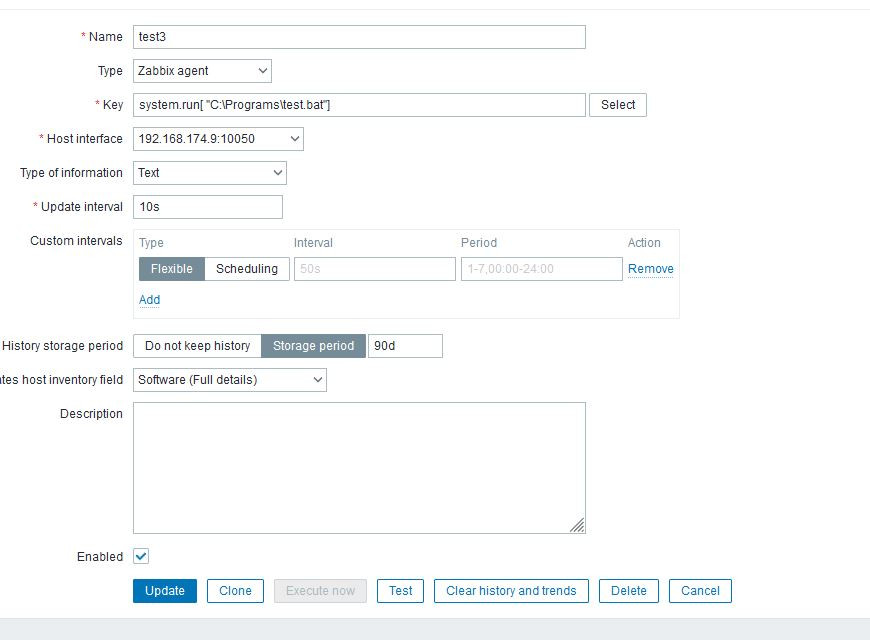

    ​Hello all,
    this is my first post in the group. I have been trying to get all the software installed on a windows machine using system.run . The Agent version is the latest 5.4
    i already updated the conf file with AllowKey=system.run[*] and EnableRemoteCommands=1​. and also ListenIP=192.168...... and ServerActive=127.0.0.1​
    The command used for the item is system.run[ "C:\Programs\test.bat"] as key. Can you please advice me here. I am lost.
    Thanks in advance.The bat code is simple:
    echo off
    wmic product get Name, Version​​

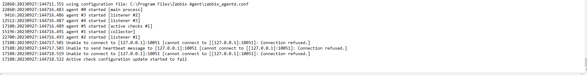

      Hi Harmardaban, Thank at first. I changed it and this is what i get on the log file.
      0652:20230927:124522.532 Active check configuration update started to fail
      80:20230927:144613.064 Zabbix Agent received stop request.
      80:20230927:144614.056 Zabbix Agent stopped. Zabbix 6.4.7 (revision 2ac20065acd).
      22860:20230927:144711.345 Starting Zabbix Agent [PC63146]. Zabbix 6.4.7 (revision 2ac20065acd).
      22860:20230927:144711.347 **** Enabled features ****
      22860:20230927:144711.349 IPv6 support: YES
      22860:20230927:144711.351 TLS support: YES
      22860:20230927:144711.353 **************************
      22860:20230927:144711.355 using configuration file: C:\Program Files\Zabbix Agent\zabbix_agentd.conf
      22860:20230927:144716.483 agent #0 started [main process]
      9416:20230927:144716.486 agent #3 started[listener #2]
      12512:20230927:144716.487 agent #4 started[listener #3]
      17108:20230927:144716.489 agent #5 started [active checks #1]
      15196:20230927:144716.491 agent Home started [collector]
      22700:20230927:144716.493 agent Forum started[listener #1]
      17108:20230927:144717.501 Unable to connect to [127.0.0.1]:10051 [cannot connect to [[127.0.0.1]:10051]: Connection refused.]
      17108:20230927:144717.503 Unable to send heartbeat message to [127.0.0.1]:10051 [cannot connect to [[127.0.0.1]:10051]: Connection refused.]
      17108:20230927:144718.519 Unable to connect to [127.0.0.1]:10051 [cannot connect to [[127.0.0.1]:10051]: Connection refused.]
      17108:20230927:144718.522 Active check configuration update started to fail​

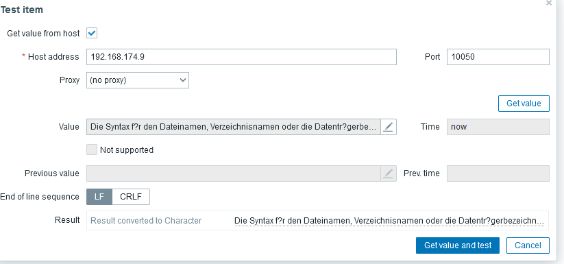

                Hi Harmardaban, Thanks a lot. i had no idea to conf file was not updating. After changing everything i am not having the same mistake anymore. But it's something else.
                • Hamardaban
                  • May 2019
                  • 2714
                  Check that there are no extra spaces after ",Version" in the command file
