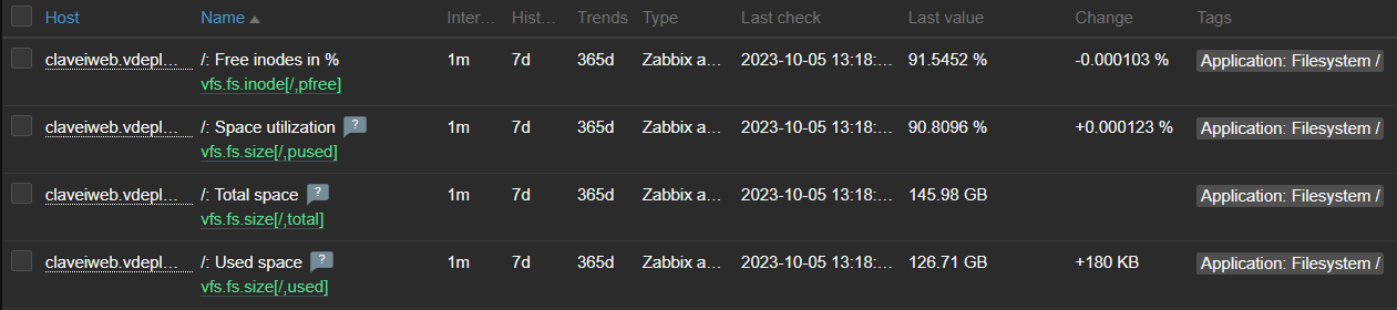

    I dicovered in "Latest Data" that the host from the original post receives the data I want, but won't show it at the dashboard. Why? All hosts have the same items and triggers, no custom ones.
    Please I still requiere hep.

      Capacity alarms need to meet two conditions: exceeding the capacity threshold and achieving a certain rate of capacity growth. It's possible that your capacity usage is high, but the growth rate is not significant, which is why some alarms may not have been triggered.
      • liujun0253
        • Oct 2021
        • 9
        In the diagram, your capacity growth rate is slow. You can go and check the trigger expressions in the monitoring template.
