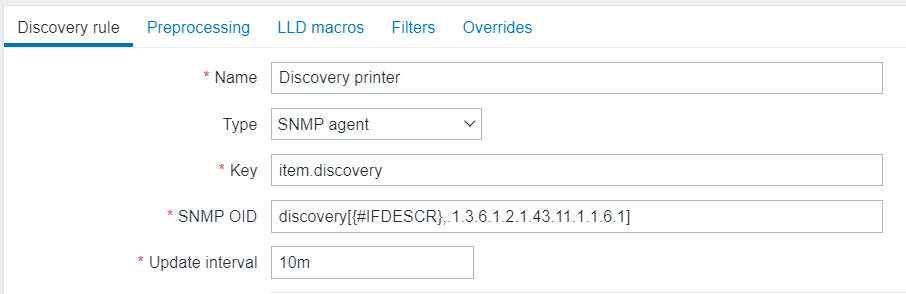

                  I'm still having issues, I dont know what more to do .
                  This is my descovery rule

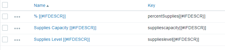

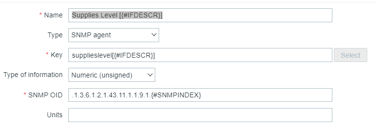

                  I just have 3 items prototypes:
                  1 item prototype
                  2. item prototype

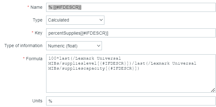

                  3. calculate item:

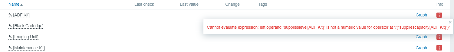

                  Everything looks good the only problem is I getting all in the string so the calculated operation
                  Cannot evaluate expression: left operand "supplieslevel[ADF Kit]" is not a numeric value for operator at "/("suppliescapacity[ADF Kit]")"
                  I'm new working with zabbix so I'm not familiar with some process, any other advice can help

                    It appears that you are continuing to enclose the functions within quotation marks in your calculated item. Why?
                    Have you experimented with the suggested formula?
                    • maarguello
                      • Apr 2023
                      • 19
                      (ñ_ñ) sorry I made a mistake, I forgot add the last(
                      after added it works, thanks for help on my issue.
