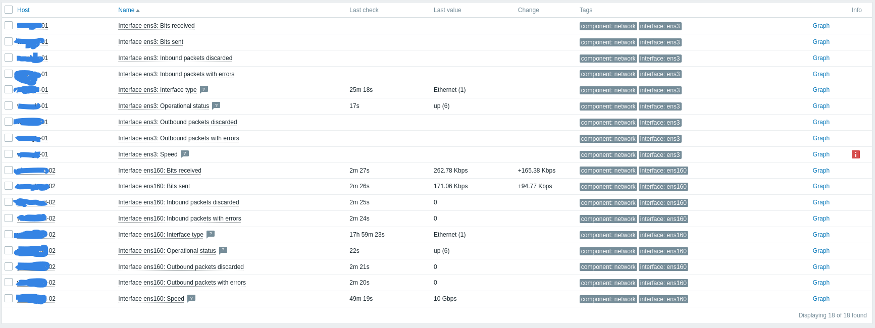

    Hello All
    Currently we are using following versions :
    - zabbix server version 6.0.15
    - zabbix agents version 5.0.32, 5.0.34,6.0.14, 6.0.18,6.0.19
    OS : ubuntu 20.04 LTS with mariadb 10.6 instance
    The problem is that the network traffic graphs are empty (no data). But when we select the host and test the item property or use zabbix_get command on zabbix server we get the values of the all the network items data.
    The template use to collect these networks traffic is the default "Linux by Zabbix agent".
    Does anybody already faced this issue ?
    Plz help.

        Can you please share the screenshot of value you received and item which discovered?
        • mbollo2005
          • Mar 2023
          As you see below the difference on displaying between server1 (no data displayed) and Server2 (data displayed) on network items collectionClick image for larger version

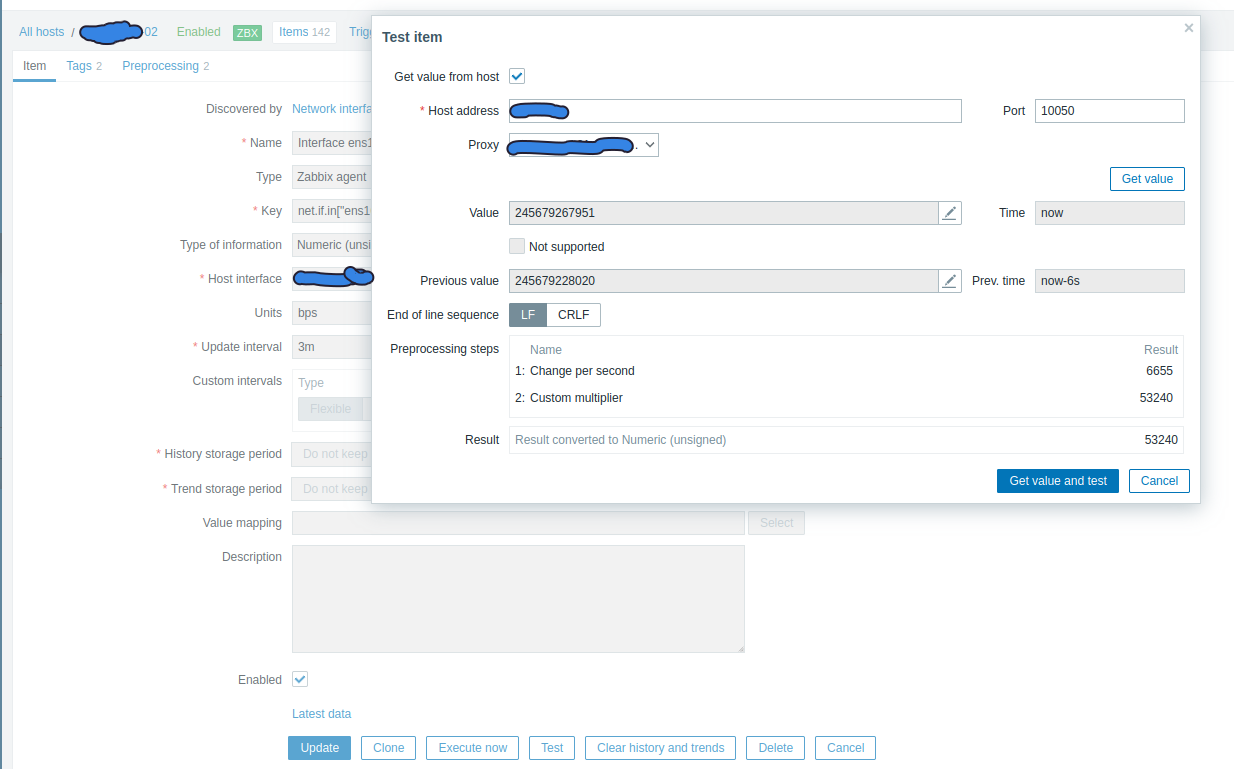

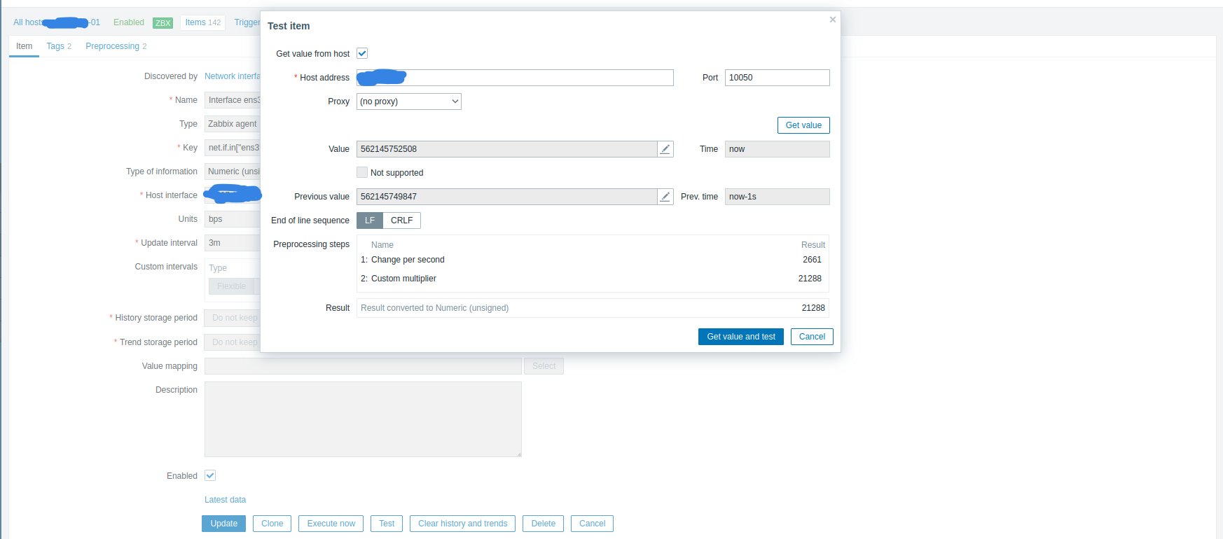

          And for when test some item we can see that the values can be collected successfully
          server1
          Server 2

                    • 4996
                    What is displayed if you click on that red "!" ? There must be an error message.
