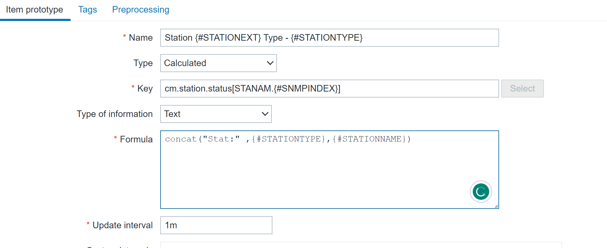

    Using Zabbix 6.4.7 and trialling some SNMP discovery jobs. The Discovery works fine, and the LLD MACROs get created, but if I try and use it in a calculated item prototype, it appears that one of the created MACROs gets corrupted.

    Created an Item Prototype

    There is no error when using it. You will notice the Macro ​{#STATIONTYPE} in the Name and the Formula When the job runs I get the following

    The {#STATIONTYPE} in the name is correct 603E1 but in the Formula, it returns 6030 - which is incorrect.
    Any ideas?

    6030 == 630*101== 630E1
    The main idea is to convert to a string.
    try {{#STATIONTYPE}.regsub((.*), \0)}

        Thank you - I should of realized when Excel started playing the same games with the data.
