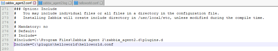

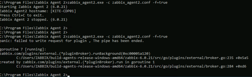

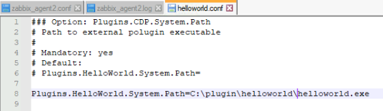

    The problem we have is when starting the agent2 after adding the new plugin to the configuration we get the following error:
    When started without the new plugin, the agent logfile appears normal. Nothing is added to the logfile when attempting to load the new plugin.
