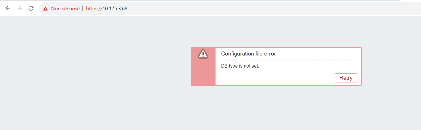

          • Serge229
            • Nov 2023
            Few progresses made :
            1. I re-installed nginx
            2. Encountered errors about "invalid PID number", "permission denied for /etc/nginx.conf"
            3. Solved the errors by changing listen to 80, server name to my web UI's IP and adding "index zabbix.php" just below server_name line
            4. Then web UI shows again, but with an error : "Configuration file error. DB type is not set."
            ​​ Click image for larger version
            • solution
              • Jun 2020
              • 272
              1 - Rename or delete the zabbix.conf.php file
              2 - access the web-gui to restart the config wizard.
              Wellington
              • Serge229
                • Nov 2023
                Hello Wellington,
                I've just followed your advice and the web UI is back.
                Many thanks !
                Serge
