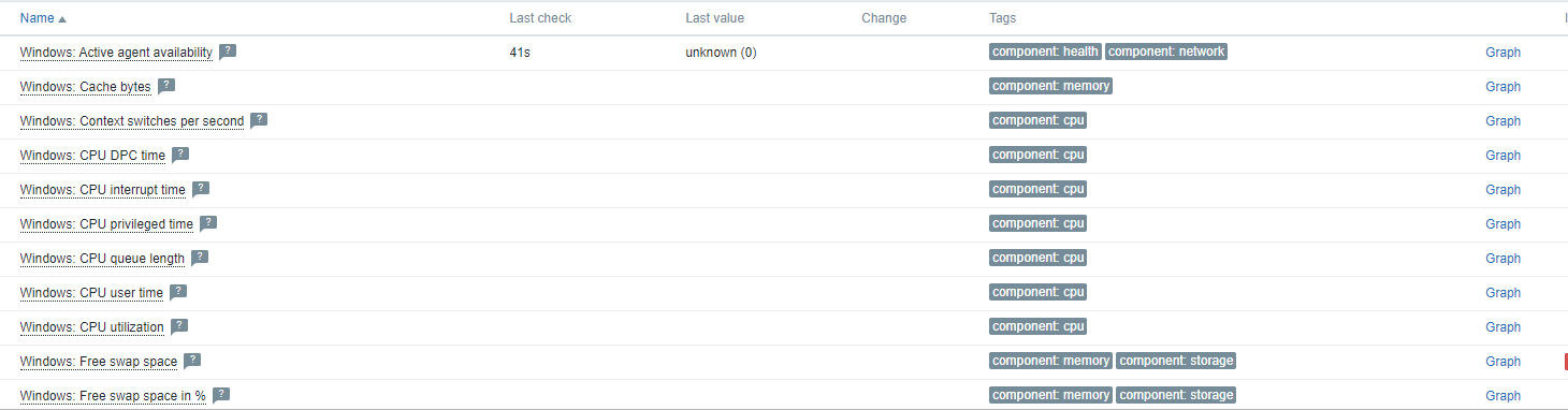

            Another note as you can see im getting no data at all, which indicates to e something isnt working as expected.
