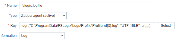

    Currently I am trying to monitor a rotating log file on a Windows client using the Zabbix Agent 2.
    The log import kind of works, but there are weird signs in the item, that do no show up when I open the file on windows.

    So I looked up the encoding possibilities at the documentation at 1 Zabbix agent
    They refer to encoding settings
    1 Zabbix agent​, that link to the libiconv - GNU Project - Free Software Foundation (FSF)​ project.
    There it is mentioned that full unicode UTF-16LE is supported.
    So I changed my item to UTF-16LE encoding
    ​​But still the log import is not right..

    Am I doing something wrong?
    Or should I file a issue report??
