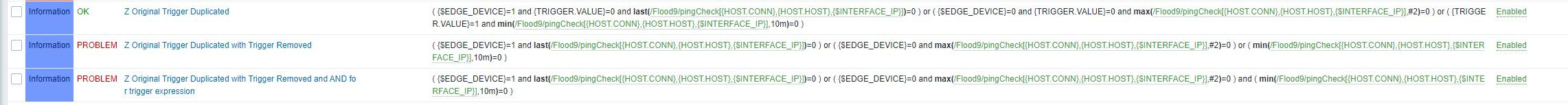

    Yeah, this is just broken. Perhaps I need to move this to the alpha feedback channel.
    Here is what I think demonstrates the issue, though it does not help localize it very well. It appears to relate to the evaluation of {TRIGGER.VALUE} perhaps in conjunction with the OR statements.
    I duplicated the templated trigger (first line) and then changed it to remove the trigger.value macro entirely (third line). notice it went to error. That's not exactly a complete test as the trigger value was effectively selecting one of the other tests, so I changed it again to do an AND between the first two (normally trigger-value = 0) and last expression (trigger.value=1). This shows that both sets evaluate as a problem, and so their OR should as well. But it doesn't.
    I then (second line) did it with a recovery expression that should be identical to the first. It also goes to error.
    I have a bunch of templates that pre-date the recovery expression that are constructed like this, and I suspect there is a lot of old code out there.
    But it looks like including trigger.value is not working properly in 7.0 Alpha 8, unless the definition has changed (and I can't find any documentation to indicate it did).
    I'm going to move (ok, duplicate as I can't move) this discussion to the feedback forum. Please reply there (https://www.zabbix.com/forum/zabbix-...er-expressions )
    Click image for larger version  Name:	trigger.jpg Views:	0 Size:	141.0 KB ID:	475523
