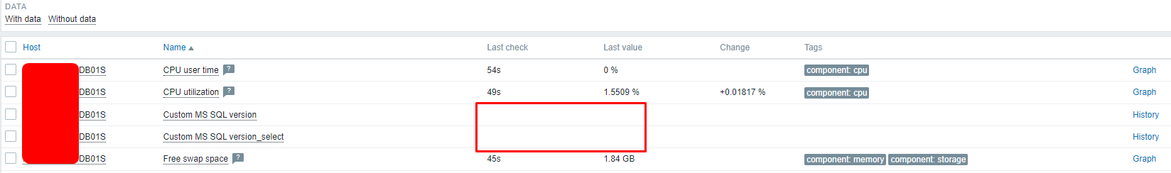

    Tests collect the data, however it is not visible through Latest Data and Database item history table is empty for that item

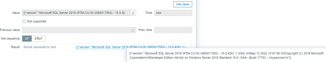

    1. Item: db.odbc.get[get_version,,DRIVER=/opt/microsoft/msodbcsql18/lib64/libmsodbcsql-18.3.so.2.1;SERVER=xx.xx.xx.xx;PORT=1433;UID=xxxxx xxx;PWD=xxxxxxxxxx;TrustServerCertificate=YES]
    'Test - Get value and test' buttons provide correct JSON response, Update interval is 5 minutes and 'Execute now' button sends request with no issues

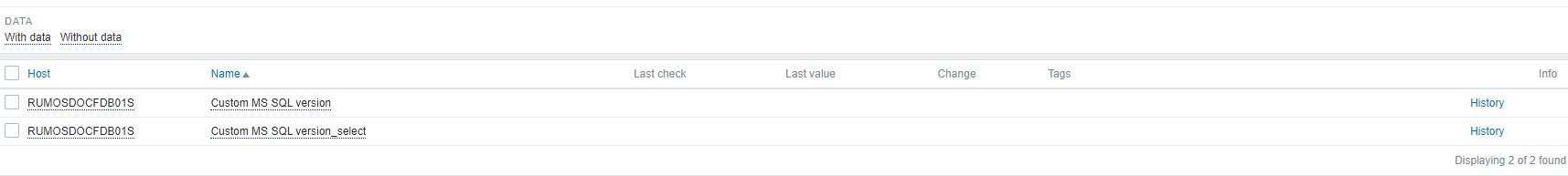

    However, latest data is empty, as well as history SQL table for that item. Other items collected with no issues. No changes in a day
