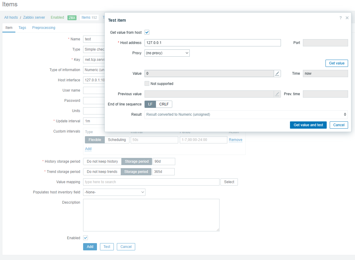

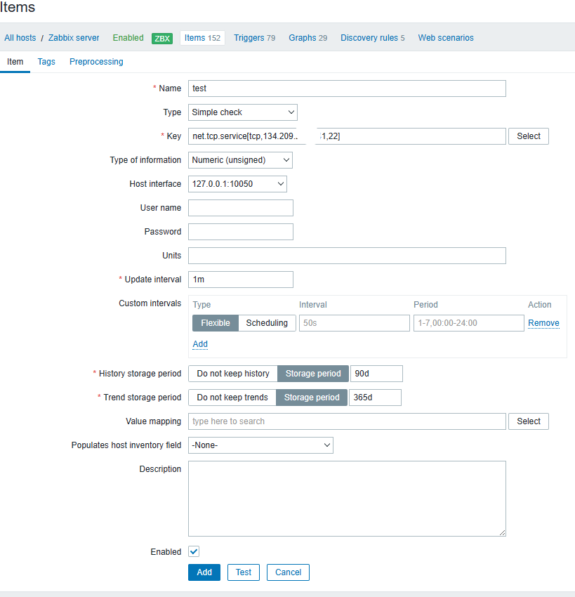

    net.tcp.service returns 0 in web interface even though work fine in cli
    Hi, I've just installed Zabbix appliance running AlmaLinux release 9.1 (Lime Lynx); Zabbix Server 6.4 6.4.1 (DigitalOcean image) and I'm playing around with some new settings in it. I discovered that the item of the simple check with net.tcp.service returns 0 when performed from the web console, however, it works fine and returns 1 when the task is performed with cli command of Zabbix server. This is the screenshot of the test item however I faced this issue by attempting use predefined template that doesn't work for me either.
    Am I doing anything wrong?

    In this case being root should not matter much... zabbix_get -s xx.xx.xx.xx... executes that command on the mentioned server as agent item. So your first line on first pic executes that check locally on that 134.209.x.x host. Second line executes it through the agent on localhost, as agent runs usually as user "zabbix" it really does not matter if zabbix_get is run as root.
    You are configuring it as simple check, which is not executed on any agent but directly on zabbix server/proxy. Even if that pic shows that Host interface is 127.0.0.1:10050, it is not really taken into account, as it is simple check (if you configure simple check on any other host, it will show there IF of that hosts agent... )
    So those are different processes executing that check .. agent vs server..
    There is a selinux boolean, controlling, if zabbxican connect to any ports... "setsebool -P zabbix_can_network 1" but IIRC, it still allows usage of common ports like 22 or 443... But still, verify....​

      Hi cyber, thank you for such a detailed description. As I see from it the permission shouldn't be an issue for simple check to operate in web interface. Unfortunately, this doesn't give me a clue what is actually wrong and how I can make simple check of net.tcp.service work on the web interface of Zabbix server. The Squid by SNMP: Squid: Service ping template doesn't returning 0 for TCP service check, which is not correct. Also as we can see any other test of the TCP check doesn't work.
      UPD: sorry, it seems setsebool -P zabbix_can_network 1 made a trick and it works fine now. Thank you a lot
