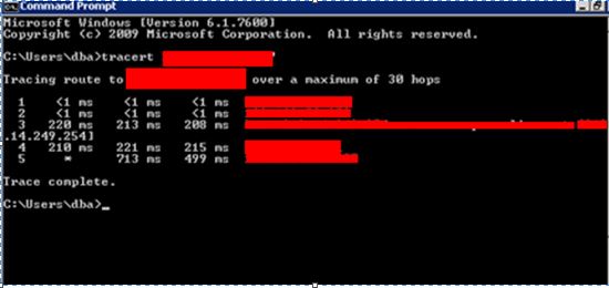

    Zabbix agent is Unreachable for 5 mins
    Zabbix Agent gets “Zabbix agent is Unreachable for 5 mins” error. When we check in local, port 10050 is open and listening, when i check logs; logs are given below. I would like to ask for your support about this.
    Zabbix Agent Logs
    50968:20160923:165446.001 Starting Zabbix Agent [Windows host]. Zabbix 3.0.0 (revision 58455).
    50968:20160923:165446.001 **** Enabled features ****
    50968:20160923:165446.002 IPv6 support: YES
    50968:20160923:165446.002 TLS support: NO
    50968:20160923:165446.002 **************************
    50968:20160923:165446.002 using configuration file: C:\zabbix\conf\zabbix_agentd.win.conf
    50968:20160923:165446.010 agent #0 started [main process]
    52208:20160923:165446.010 agent #1 started [collector]
    50440:20160923:165446.044 agent #2 started[listener #1]
    52888:20160923:165446.044 agent #3 started[listener #2]
    51608:20160923:165446.045 agent #4 started[listener #3]
