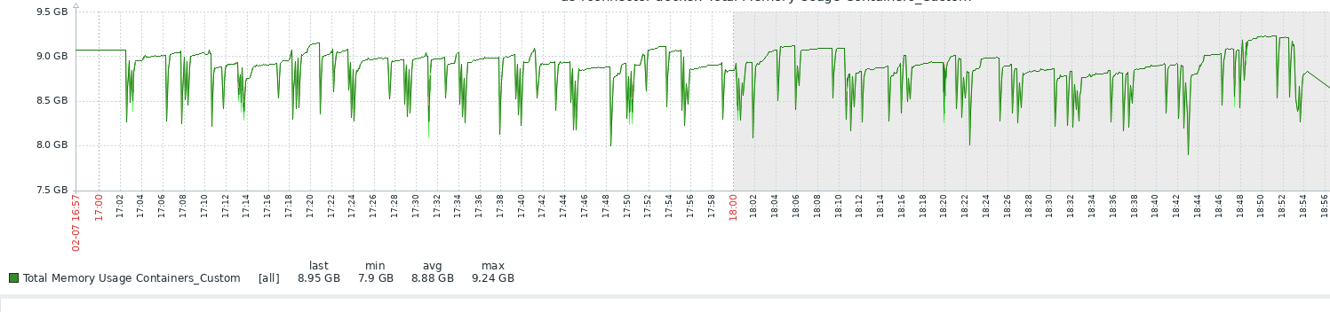

    s3ct0r
    • Feb 2024
    Done with a custom script.
    following the Script:
    docker stats --no-stream --format 'table {{.MemUsage}}' | sed -n '1!p' | cut -d '/' -f1 | sed 's/GiB/ * 1024 MiB/;s/MiB/ * 1024 KiB/;s/KiB/ * 1024/; s/$/ +\\/; $a0' | bc | numfmt --to=iec-i --suffix=B

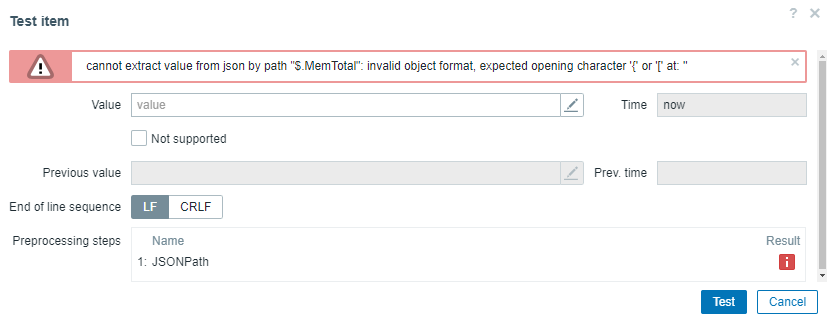

      • s3ct0r
        • Feb 2024
        Hello Shaman0S,
        if i test manually i get an error,
        and on the server
        user@server-01:~$ docker info | grep -i mem
        Total Memory: 15.61GiB
        But this memory is the total memory of the server, not the total memory used by docker.
        Any ideas?

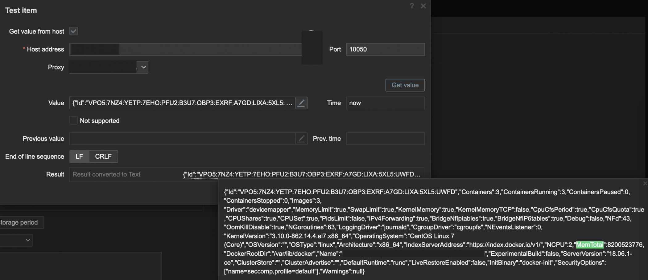

        • Shaman0S
          • Sep 2022
          • 11
          You need to test parent docker.info item (see screenshot below)
          Check if MemTotal is inside json output
          • s3ct0r
            • Feb 2024
            Hi Shaman0S​,
            i dont see the first foto,
            can please upload again?
            P.S yes the
            "MemTotal":16756031488
            is there, but this isn't the total usage of the docker, this is the total memory of the server.
            Any ideas?
            • Shaman0S
              • Sep 2022
              • 11
              Also,
              That's true and by design. You may want to look into Memory usage items for your containers as stacked graph. It will bring you overall picture of memory consumption by containers (similar to `docker stats`output)​

                    • s3ct0r
                      • Feb 2024
