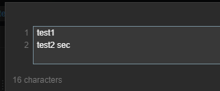

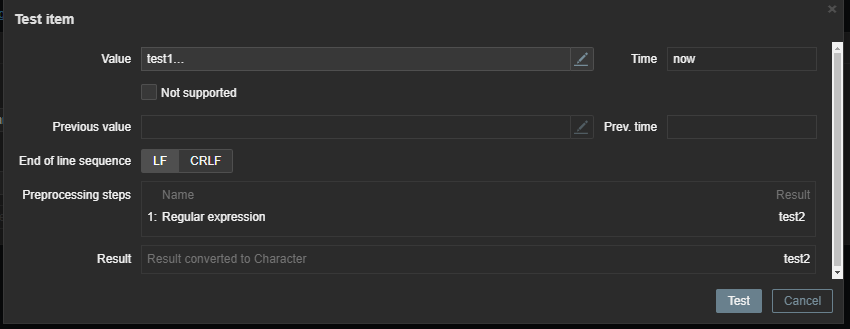

        Try Regex generator to match your need.
          • 4996
          I don't understand, what is not working? You do have one extra "." there... after \s​
