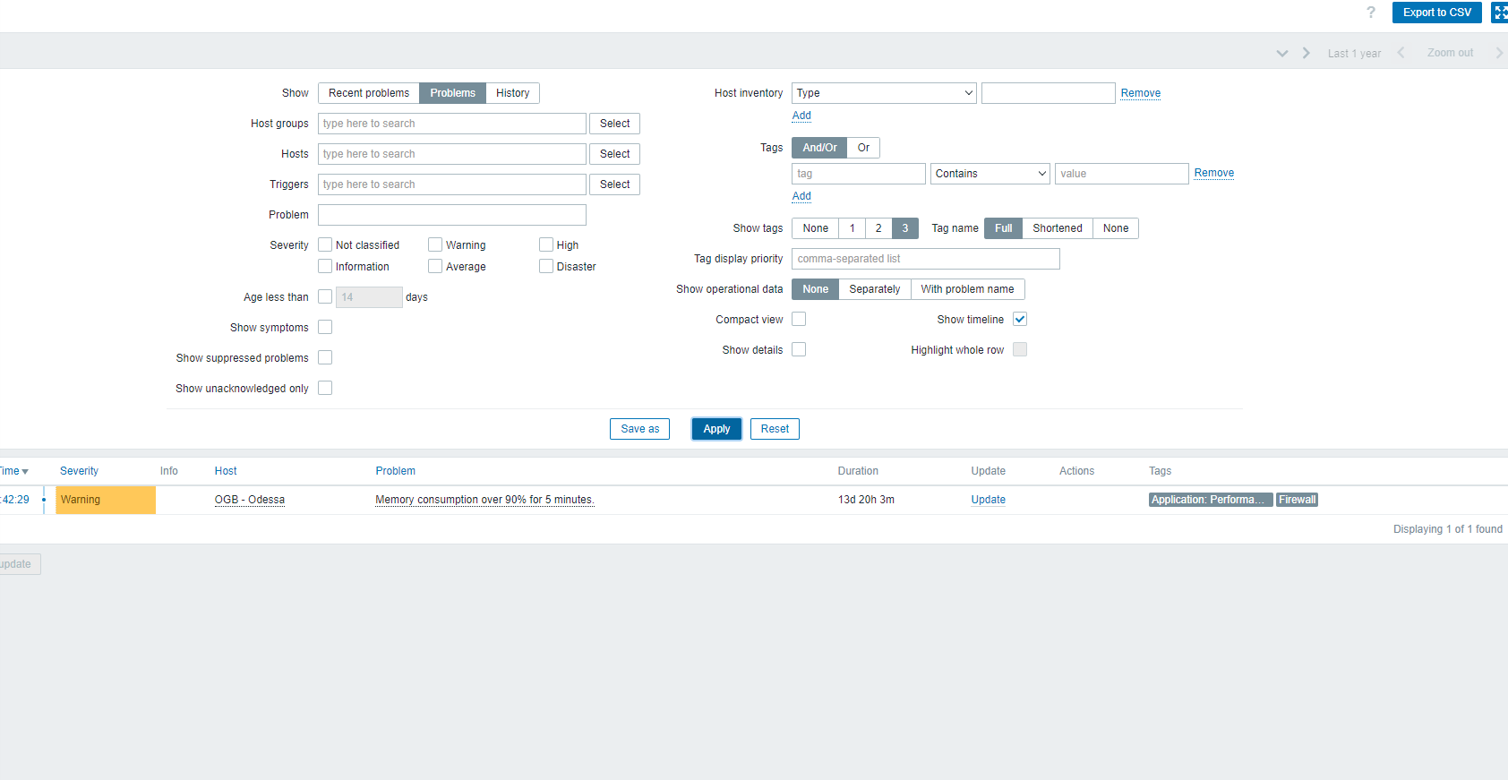

    Hello All,
    New to Zabbix here. Surely a device that stops becoming available should be listed as a problem?
    I have 3 devices that are timing out; however, they don't appear on the Problems page. The thought was to only stay on the Problems page to be aware of issues.
    • 4996
    Problems page only displays those problems that are generated by trigger conditions. If you have no trigger defined to detect agent connectivity issues, you do not see it.
