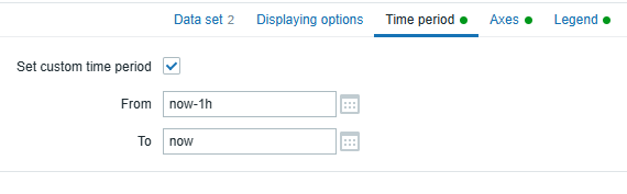

        • GZV
          • Jul 2025
          I had the same problem and stumbled upon this post while looking for an answer.
          I fixed it by flagging the "Set Custom time period" in the time period tab, probably due to an accidental drag on the graph itself that lead to a custom time period.
          Hope it helps
