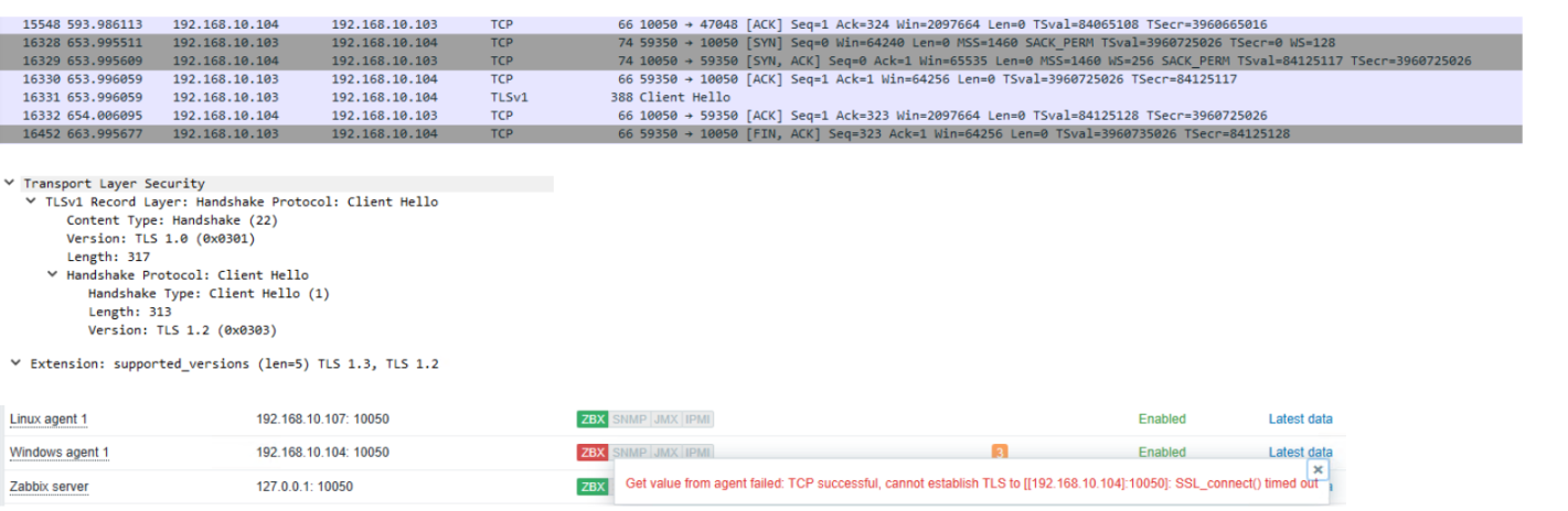

    Greetings,
    I am experiencing some difficulties while trying to configure TLS communication between Zabbix server and agent 2 (linux and windows) with psk key. No proxy for the moment and Communication worked just fine with unencrypted communication.
    #Problem:
    TLS handshake does not complete and impossible to restart agent 2 (linux and windows) in order to reload new configuration. So I kill process on linux and end task in task manager in windows.
    TCP handshake is ok, but not TLS (see picture below)Same error in server log, and on agents side C source code TLS functions seem to run again and again (=> connection timed out) and nothing happen after agent-side in the logs (agent freeze)
    As you can see in the wireshark screenshot below, the TLS version seems to be 1.2 but not sure of it.
    I forced TLS 1.2 on server side (verify with openssl cipher -v) but it did not change anything.
    I verify firewall configurations and everything seems ok
    I verify in windows registry and I enabled server and client TLS 1.2
    I verify the time.
    PSK and PSK identity is matching for each agent separetly and server
    PSK is also configured correctly on the server frontend
    Similar topic on this forum have network congestion or proxy misconfiguration. I have no network congestion, no proxy and I did not see that agents freeze in any simillar topic.
    Any idea what I could do to solve this problem? New to Zabbix so any help would be great!

      You're correct that the other forum threads you found aren't relevant for your situation.
      Have you tried the "zabbix_get" example from the Zabbix Encryption documentation, to see if zabbix_get from the agent itself works? https://www.zabbix.com/documentation...re_shared_keys
      If zabbix_get from the same host works then the problem is either that you have something misconfigured on the server OR (my suspicion) the differences in server OpenSSL version and the clients means that the server can't successfully negotiate with the newer TLS implementations on the clients. You've done the right thing by making sure that TLS 1.2 is enabled on at least the Windows client, since TLS 1.2 is probably the only version that OpenSSL 1.1.1n from the server and the clients would both support. It's still possible though that they're not agreeing on ciphers or there's some other problem.
      My site isn't using zabbix_agent2 yet so I'm not very familiar with what configuration options it supports, but at least the traditional agent supports various options to override the ciphers used for either PSK or certificate-based authentication. For example, TLSCipherPSK. Does the zabbix_agentd2 support something similar in its conf?
      You're using different pre-shared keys for each client as outlined in the documentation, correct?
