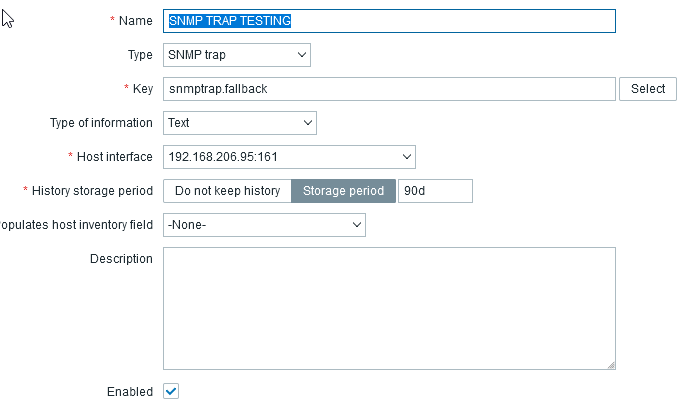

    What is your SNMP trap item configuration?

      Thank you for your reply. You will find attached the SNMP trap item. snmp fallback has been choosen. The IP address is the one of the device to be monitored. If I send an SNMP trap from this device the parsed file to send to Zabbix is as following: The header is correct and we see that the device is sending SNMP to my proxy on UDP/162. But I still have no collected data on my host 192.168.206.95.
      Zabbix Server and proxy are not on the same timezone. Is it possible that Zabbix server cannot process current date format?

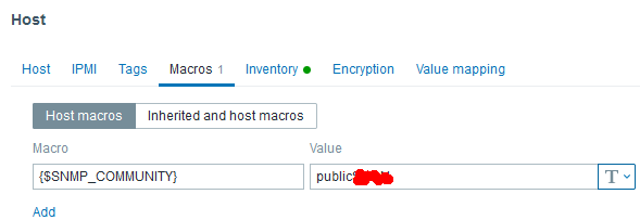

          I have changed Host item to Log and sent a new SNMP Trap test from my device. The log is still generated of course but no data are coming to Zabbix Server. I'm using a custom community which is publicYYYY (masked characters were removed from the last log indeed - I have written YYYY now). I also have double checked it's value and changed the default {$SNMP_COMMUNITY} macro of course. See attached file.
          It makes me nuts...
