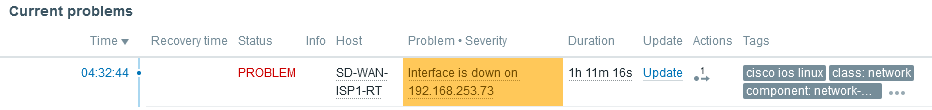

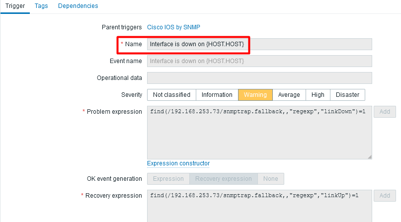

    i am able to receive snmptraps and email notification but i am not able to make accurate with use of regexp as i wanted. i want to display interface Descr. from IFMIB in the event but as soon as i use the regexp it throw me full log message of snmptrap. any suggestion solution will be highly appreciated...below are my try

    Trigger Name and Condition

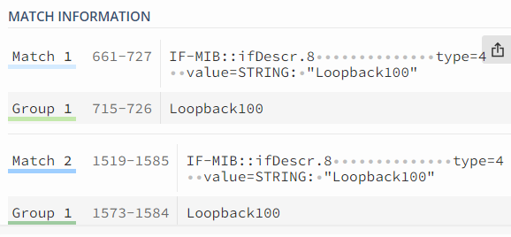

    Interface {{ITEM.LASTVALUE}.regsub(IF-MIB::ifDescr.*"(.*)")} is down on {HOST.HOST} ( i have cheked regex101.com IF-MIB::ifDescr.*"(.*)" matching the condition from snmptap raw data as show below )

    what i wanted to dispay is interface <REGEXP MATCH> is down on <HOST> ​

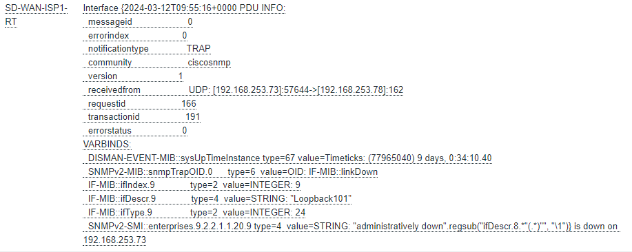

        regsub also requires you to specify, which match group you want to show... so {{ITEM.LASTVALUE}.regsub("IF-MIB::ifDescr.*"(.*)"","\1")}
        • nms_allinone
          • Mar 2024
          • 11
          same error no luck...where i am doing wrong ?
