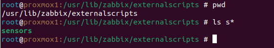

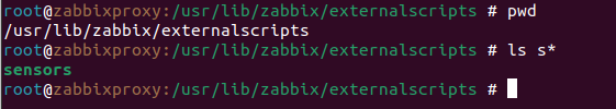

              Same error even with the script on the right directory and external check ON.

                • 4996
                Verify script access rights... "namei -mo /usr/lib/zabbix/externalscripts/sensors" . It has to be accessible by user "zabbix"
