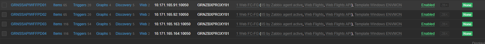

    Below I have changed the servers ending 01 and 02
ID:	481566Servers ending 01 and 02 not showing status available​

    servers that have not had their IP changed
