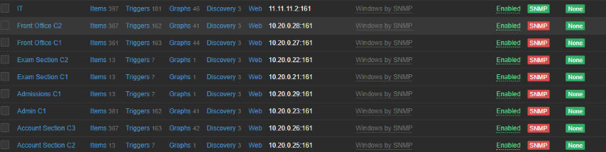

    Hello everyone,
    I'm currently facing an issue with my Zabbix monitoring setup and could use some assistance. Here's my situation:
    • I have a Zabbix server installed on subnet 11.11.11.1/24.
    • Additionally, I have separate subnets for LAN, AP, IoT, etc.
    • When attempting to add a Windows host using the SNMP template, I'm unable to see the host. Only hosts within the same subnet where the Zabbix server is inatslled is appearing.
    I suspect there might be a configuration issue preventing monitoring across different subnets. Could someone please advise if there are specific configurations I need to adjust to enable monitoring across subnets in Zabbix? Any insights or suggestions would be greatly appreciated.
    Thank you in advance for your help!
  • LenR
    • Sep 2009
    • 1011
    Are the other subnets routable from your Zabbix server network? If so, Zabbix should work.
