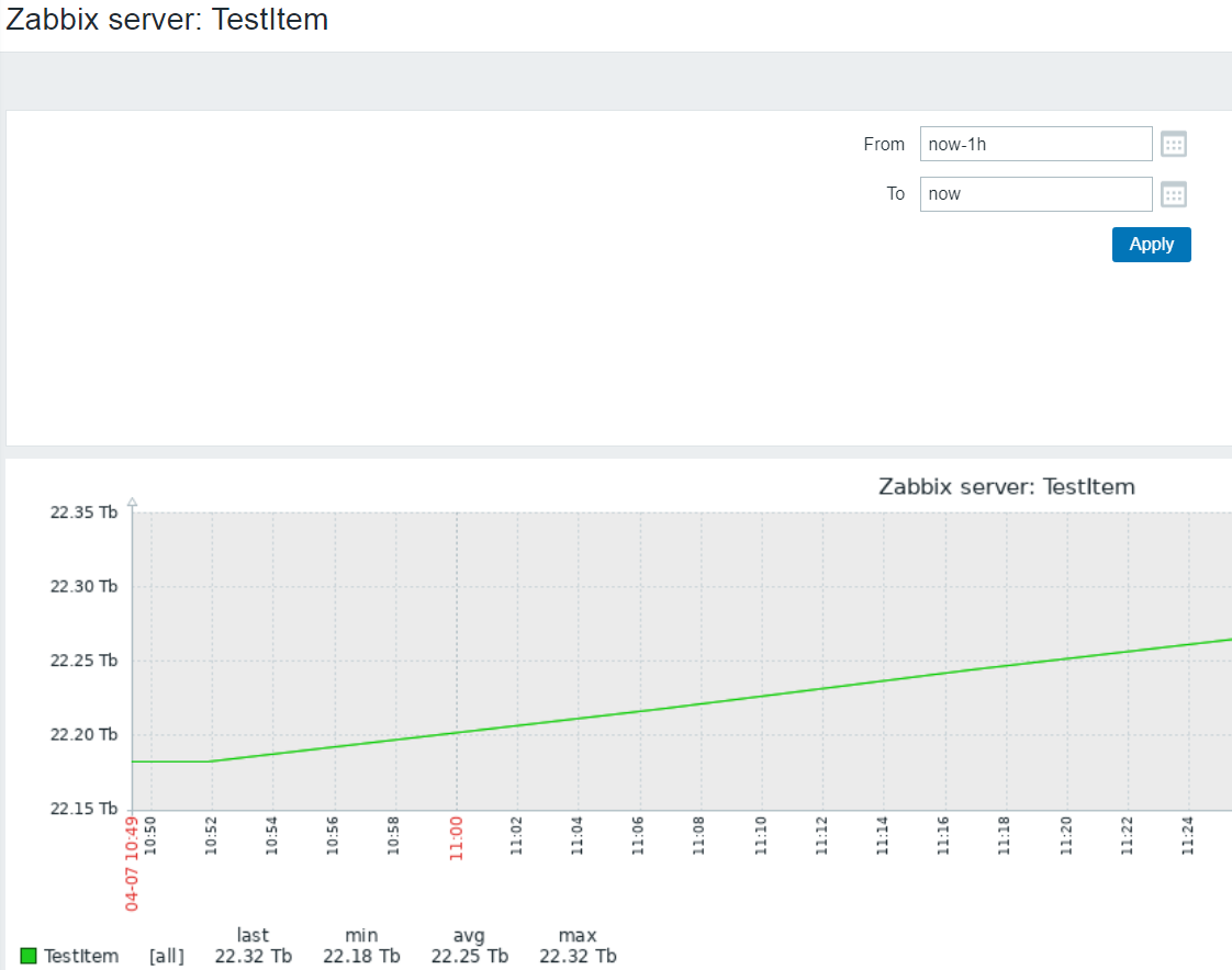

    2. The item is working and under Monitoring -> Latest Data I can see the item and it has latest actual values. But when I go via Data Collection -> Hosts -> Select Host -> Item -> Latest data, I receive: No data found. When I go via Data Collection -> Hosts -> Select Host -> Item -> Graph, I see a fully working graph of that item.

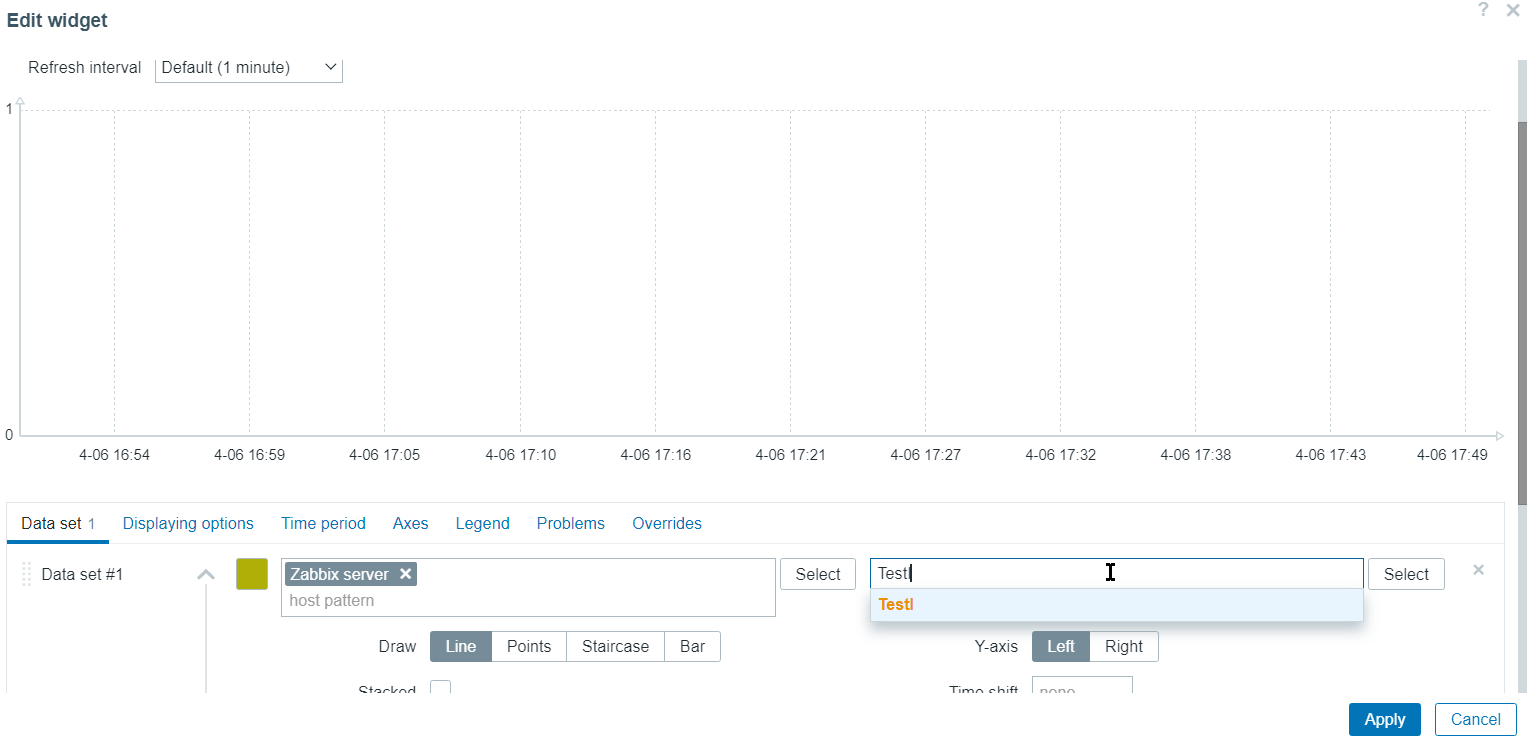

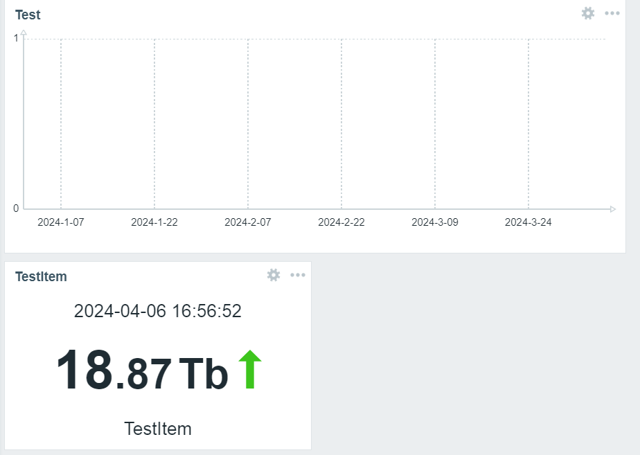

                So look: I pick an item, that is fully working and clone it.
                The new item appears and I can change name and assign a new key. I chose TestItem as name.
                When I save, I expect the new item to work exactly as the original I have cloned it from.

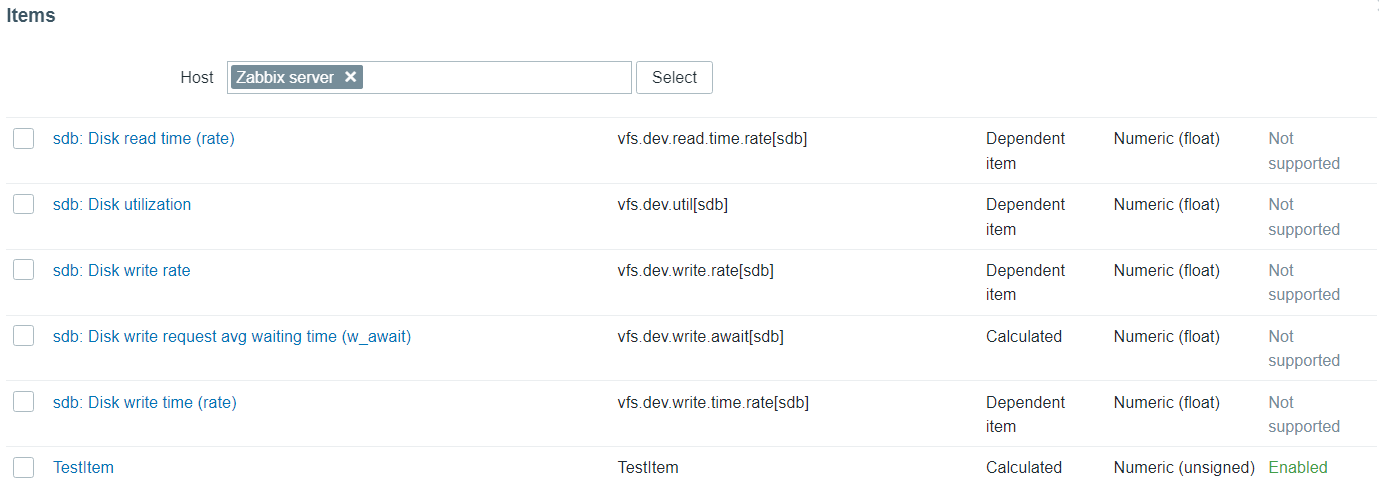

                So I try to add it as graph to a dashboard. However when I type the name into the select field as item pattern, the name of the new item does not appear. When I click on select then I can scroll through all items and find the name of the new item. I can select it. But no graph appears.
                Same goes for when I add the item with widget item value. I can not select it via item pattern only via Select and scroll. But this time (with the item value widget) I get values for the item.

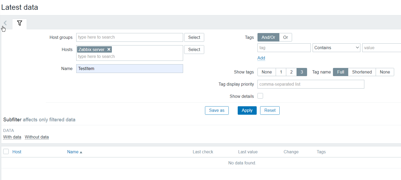

                  Let me add some more description:
                  When I go to Monitoring -> Latest data -> Zabbix Server, I enter 'TestItem' as name, nothing gets found:

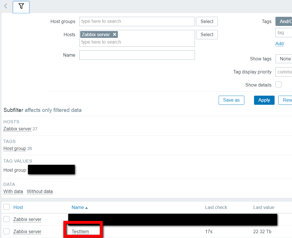

                  But the item is there, it even has values. When I do not enter the name:
                  And it has a graph, so it is very strange that there is no graph when I try with the graph widget:
                  So the item is basically fully functional, but only in theory. It does not show its values/graphs everywhere and cannot be searched for.
