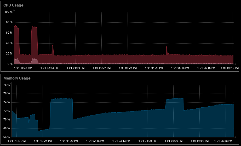

        This is `now to now-8h`

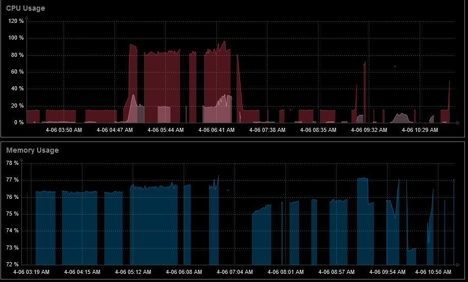

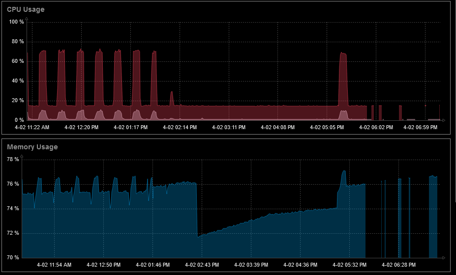

        Below are graphs from `now-5d to now-5d+8h` and `now-4d to now-4d+8h`
        Click image for larger version  Name:	Capture2.png Views:	0 Size:	33.8 KB ID:	481991 Click image for larger version  Name:	Capture1.png Views:	0 Size:	44.3 KB ID:	481992
        You can see when data started to break. I checked journalctl on both server and agent, nothing out of the ordinary leading up to the issue.
