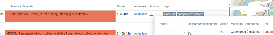

    I would like to restart my snmp service automatically (10 mins later) when the zabbix "service stopped" alert is triggered.
    without success,
    agent version 6.4 zabbix
    below my configurations (see captures)

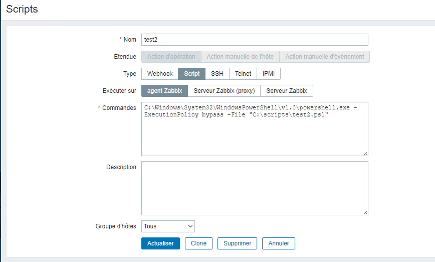

    I authorized on the agent zabbix windows
    AllowKey=system.run[*]
    from zabbix server:
    Action->SCRIPT
    any idea?
    thanks in advance​

        Hello Markosa,
        thanks for the feedback,
        in the GUI, I have
        Remote command Failed
        "Get value from agent failed: cannot connect to [[192.167.17.40]:10050]: [111] Connection refused"

          • markosa
            • Aug 2022
            • 107
            So, have you allowed connections to agent from server/proxy? This "Get value from agent failed: cannot connect to [[192.167.17.40]:10050]: [111] Connection refused" looks like you haven't, check firewall(s), selinux etc.
            Also, read Zabbix documentation, it's quite good.
