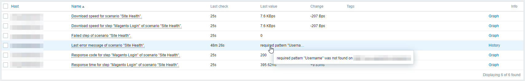

    The site should be considered up if the keyword "Username" exists, and the staus code is 200.
    When looking at the result, it states that the keyword could not be found:

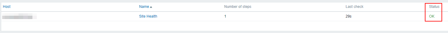

    Although, ​the "Failed step" is 0, which seems incorrect to me. Furthermore, if I look at the status of the Web Scenario, it says OK:

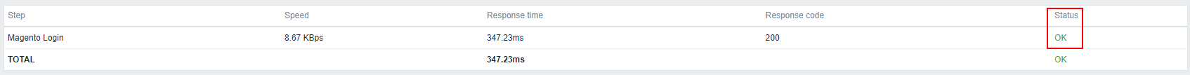

    The same goes for the step itself:
    I don't get why the status is OK, even when the keyword is not found. Furthermore, I don't get why the keyword is not found.

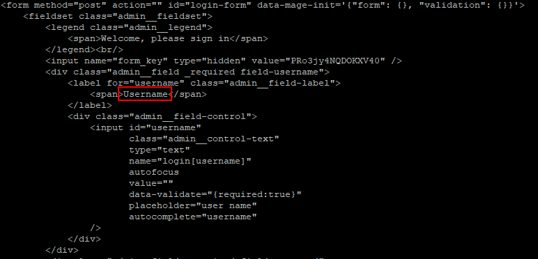

    I have enabled debugging and the log shows that the site is parsed and that the keyword is indeed there:

    Everything is just as it should be.. That field displays last error message... as you see it is 48 minutes ago, not 25 seconds as all other data... Last data by default show you up to 24h old data... so by tomorrow it wil not even show up any more...

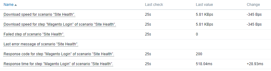

        Thanks for clarifying!
        As the column title is "Last Value" I would have expect that the result was something like "required pattern found". But your explination make perfect sense and the last result (error) is indeed gone!
