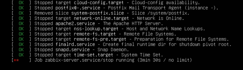

    The reboot process hangs too, it hangs when try to stop zabbix-server service:
    Click image for larger version  Name:	KHpvwVYF00.png Views:	0 Size:	85.2 KB ID:	482716
    I had to force restart the machine via VMWare.

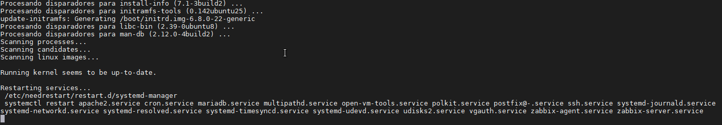

    After several researchs and investigations I can see that the problem occurs always after system try to do the daily update, after execute "apt upgrade", then I decide to try in interactive executing "apt upgrade".
    When I execute "apt upgrade" several packages were installed but the process hangs when try to restart the services:
    Click image for larger version  Name:	eTfzDstYiT.png Views:	0 Size:	25.0 KB ID:	482717
