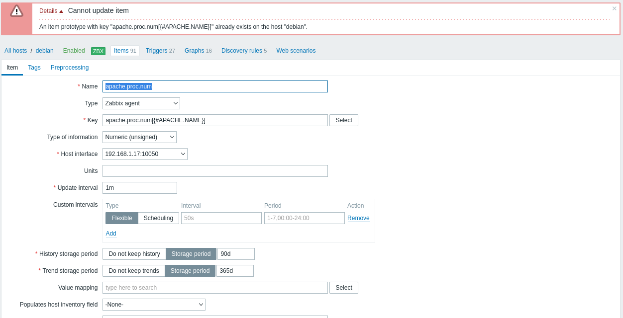

    Hello everyone, I'm trying to monitor my Apache server using the Apache template. I'd like to use the prototype trigger "Apache: Process is not running" with the expression "last(/Apache by Zabbix agent/apache.proc.num[{#APACHE.NAME}])=0". The problem is that when I try to create the "apache.proc.num" key, it accepts it, but tells me it's an unsupported key. And when I try "apache.proc.num[{#APACHE.NAME}]", it gives me an error saying it already exists in my item prototypes, and the test doesn't work either (see screenshot). I'm a bit lost, does anyone have any ideas?

    look under discoveries. it should be there.. verify that your discoveries are working correctly..
