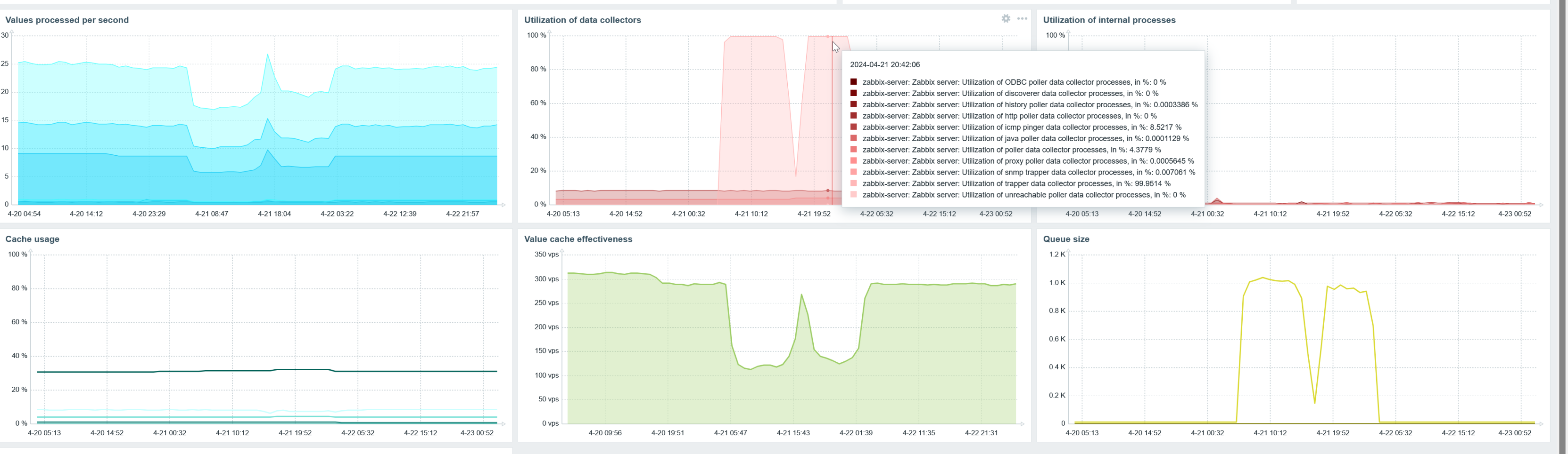

    Additional info.
    When I've added 2 cloned hosts:
    1. I've got the problem triggered: " Zabbix poller processes more than 75% busy"
    2. the metric "Zabbix server: Utilization of trapper data collector processes, in %:" hiked to 100 %. But I have no trapper items in the templates configured and the agents don't have any plugins.
    This is how it looked on the graphs
    Click image for larger version  Name:	image.png Views:	0 Size:	603.5 KB ID:	482928
