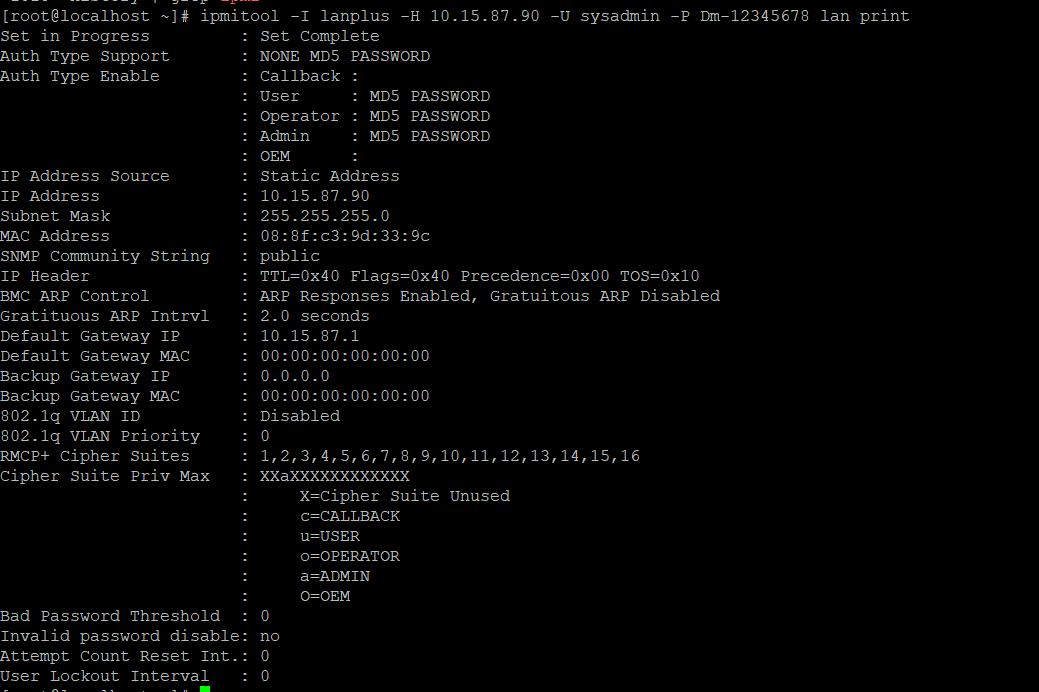

    However, ipmitool works it:
    Click image for larger version  Name:	image.png Views:	0 Size:	60.4 KB ID:	483466
