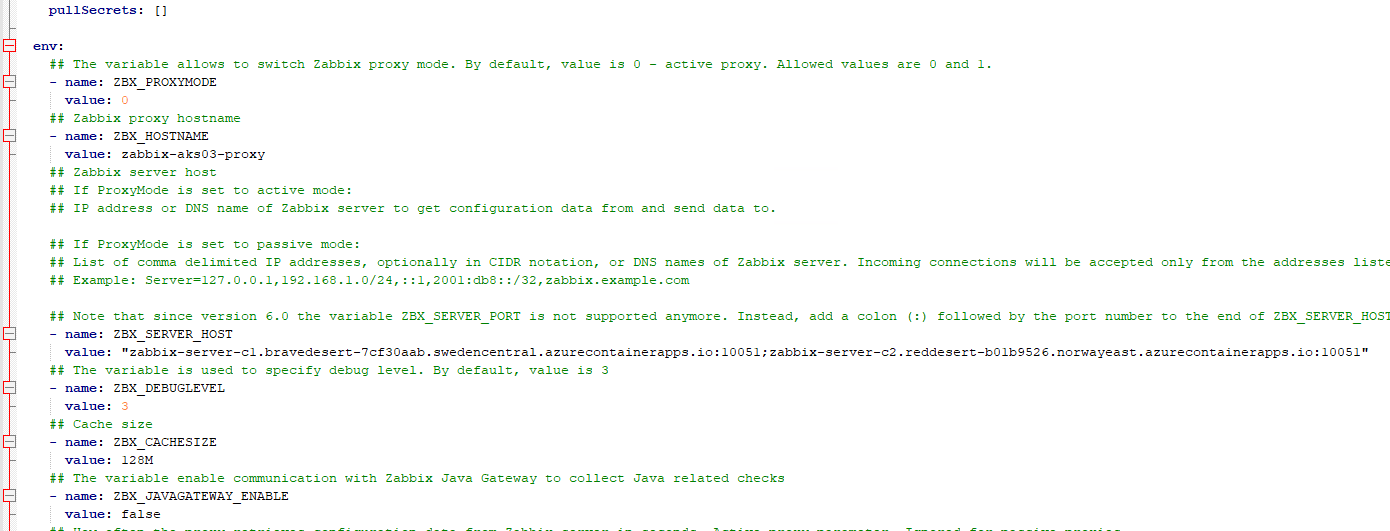

    You have space before semicolon,is that copy-paste problem or is it in configuration? It would help if you would show all active lines(not starting with #) within this(remember sanitize). For example using grep -v "#" /etc/zabbix/zabbix_proxy.conf, in our system it returns like this:

      Hi!
      Hmm could be it, there is seem to be a space in the configuration.

      Server=zabbix-server-c1.bravedesert-7cf30aab.swedencentral.azurecontainerapps.io:10051 ;zabbix-server-c2.reddesert-b01b9526.norwayeast.azurecontainerapps.io:10051

      Here is the helm variables (no space):
