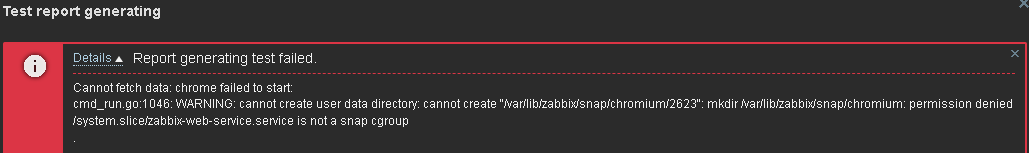

    Cannot fetch data: chrome failed to start.
    cmd_run.go:1046:WARNING: cannot create user data directory: cannot create "/var/lib/zabbixsnap/chromium/2623: mkdir /var/lib/zabbix/snap/chromium: permission denied
    /system.slice/zabbix-web-service is not a snap group

    now when I try to run a test scheduled report I now get this error on screen (below)
    Report generating test failed
    - cannot fetch data: chrome failed to start
    - cannot create mount point /tmp/snap.rootfs_KKKPNa//var/lib/zabbix/snap/: read-only file system
