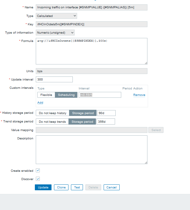

            Here is my itemids,and also i write
            Custom intervals​>Scheduling>m0-59/5
            but still they are not sync!
            also I use snmp!

              Originally posted by cyber
              Then schedule your checks, if they have to be at exact moments...
              Could you please point out any mistakes I made?
                • 4990
                You are scheduling your calculated item, but you are not scheduling items which collect data... thus, (I think), you are just chasing the wind on a field here... trying to calculate on a precise moments, when it really does not matter... couple of seconds here and there, when data can come in on a different schedule...
