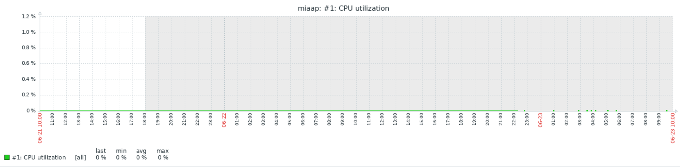

                  I have been trying to troubleshoot this but as yet cannot fathom what Zabbix is doing.
                  Template is "Mikrotik by SNMP". Hosts are added by hostname and not IP.
                  net.if.wireless.walk is:
                  walk[1.3.6.1.4.1.14988.1.1.14.1.1.2,1.3.6.1.2.1.31.1.1. 1.18,1.3.6.1.2.1.2.2.1.3,1.3.6.1.2.1.2.2.1.7,1.3.6 .1.4.1.14988.1.1.16.1.1.2,1.3.6.1.4.1.14988.1.1.16 .1.1.4,1.3.6.1.4.1.14988.1.1.16.1.1.3,1.3.6.1.4.1. 14988.1.1.16.1.1.7,1.3.6.1.4.1.14988.1.1.1.3.1.4,1 .3.6.1.4.1.14988.1.1.1.3.1.8,1.3.6.1.4.1.14988.1.1 .1.3.1.9,1.3.6.1.4.1.14988.1.1.1.3.1.6,1.3.6.1.4.1 .14988.1.1.1.3.1.11,1.3.6.1.4.1.14988.1.1.1.7.1.5, 1.3.6.1.4.1.14988.1.1.1.7.1.4,1.3.6.1.4.1.14988.1. 1.1.7.1.2,1.3.6.1.4.1.14988.1.1.1.7.1.3]
                  When SNMP availability icon goes red, hover over it:
                  cannot resolve address [[miaap]:161]: timed out: nodename nor servname provided, or not known
                  It's complaining that it can't resolve it, I think? The DNS server is running on the same host as the Zabbix server. Nslookup *always* returns the correct answer, instantly. Nothing is ever logged about DNS in the Zabbix server log.
                  It didn't have any problem with DNS until around 2200 yesterday, which is when I uploaded the Zabbix 7 version of "Mikrotik by SNMP", used by this host [this updated the template from the factory 6.0 version]. I am quite sure that this is not a DNS problem
                  Server log:
                  1945097:20240623:095124.030 enabling SNMP agent checks on host "miaap": interface became available
                  1945135:20240623:095124.185 SNMP agent item "sensor.temp.walk" on host "miaap" failed: first network error, wait for 15 seconds
                  1945135:20240623:095139.192 SNMP agent item "net.if.wireless.walk" on host "miaap" failed: another network error, wait for 15 seconds
                  1945097:20240623:095154.069 resuming SNMP agent checks on host "miaap": connection restored
                  1945135:20240623:095154.184 SNMP agent item "net.if.wireless.walk" on host "miaap" failed: first network error, wait for 15 seconds
                  1945135:20240623:095209.193 SNMP agent item "sensor.temp.walk" on host "miaap" failed: another network error, wait for 15 seconds
                  1945135:20240623:095224.197 SNMP agent item "net.if.wireless.walk" on host "miaap" failed: another network error, wait for 15 seconds
                  1945135:20240623:095236.204 SNMP agent item "net.if.wireless.walk" on host "miaap" failed: another network error, wait for 15 seconds
                  1945097:20240623:095251.141 resuming SNMP agent checks on host "miaap": connection restored
                  1945135:20240623:095251.188 SNMP agent item "system.cpu.walk" on host "miaap" failed: first network error, wait for 15 seconds
                  1945135:20240623:095306.197 SNMP agent item "net.if.walk" on host "miaap" failed: another network error, wait for 15 seconds
                  1945135:20240623:095321.196 SNMP agent item "net.if.wireless.walk" on host "miaap" failed: another network error, wait for 15 seconds
                  1945135:20240623:095336.195 temporarily disabling SNMP agent checks on host "miaap": interface unavailable

                    Whilst in an "unresponsive" state, I can force a check on a specific item, it will work and store the retrieved value, but that doesn't actually clear the "unresponsive" flag on the host in Zabbix. Interesting.

                          Yes, miaap is the name. It has only an AAAA record, no A record. It resolves just fine with either the bare host name or the FQDN.
                          Disabling all of the walk[] items stopped the SNMP unreachable alerts.
                          DNS server is bind. The configuration is a bunch of text files.
                          OS resolver configuration is
                          nameserver 127.0.0.1
                          nameserver 8.8.8.8
                          search <my domain>
                          "The library keeps track of the state of nameservers and will avoid them when they go down. Otherwise it will round robin between them."
                          Having Google public DNS second doesn't actually mean that it will only be used if 127.0.0.1 isn't working in this case
                          I removed it from /etc/resolv.conf, restarted zabbix-server and now I am no longer getting SNMP unreachable messages with these walk[] items enabled!
