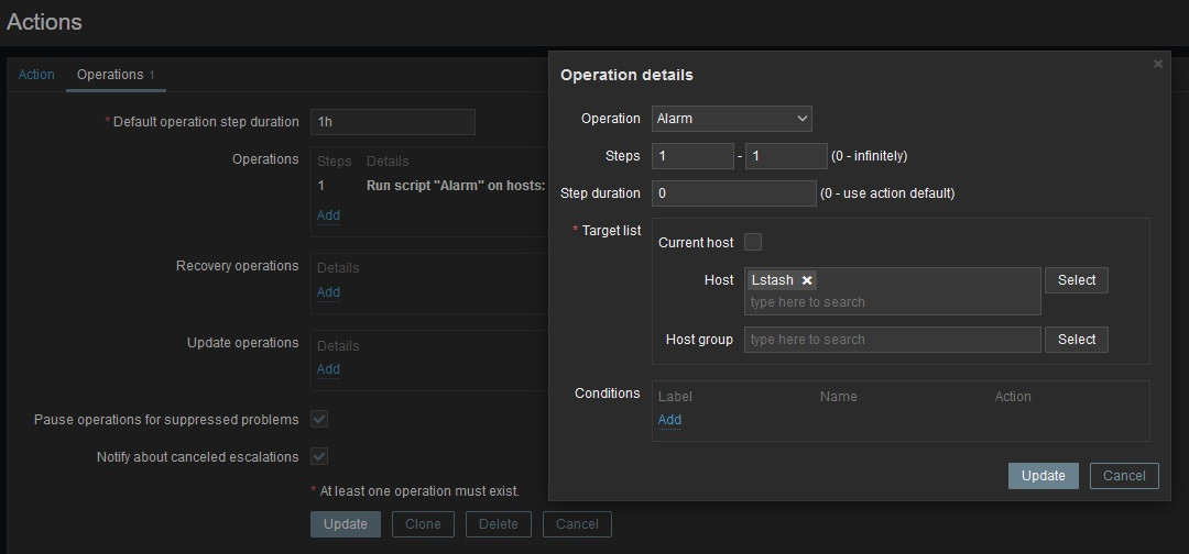

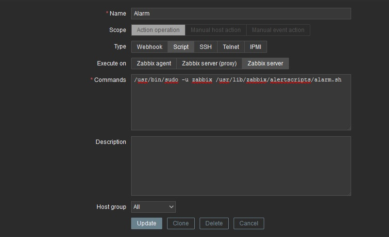

    I have created a script on zabbix GUI (zb1) and created a trigger action that use Alarm script for a host now when my trigger fire on the host action status failed and show
    Also this is my script permission :
    [root@Zabbix ~]# ll -hrt /usr/lib/zabbix/alertscripts/alarm.sh
    -rwxr-xr-x 1 root root 78 Jun 11 15:48 /usr/lib/zabbix/alertscripts/alarm.sh
    but while we run script manually it is working
    /usr/bin/sudo -u zabbix /usr/lib/zabbix/alertscripts/alarm.sh
    • 5004
    Zabbix runs as local user called "zabbix", why do you put root permissions to a script and try to run that script sudo-ing from zabbix to zabbix and expect it to run? Probably missing sudo rules for that also? Change script ownership to zabbix, get rid of that sudo and run it as much as you like... If that script has to be run as root , then it might work if you sudo without "-u zabbix" and have those sudo rules in place, that zabbix can execute that script as root.

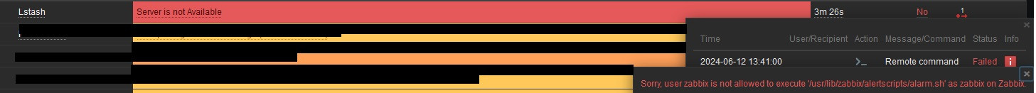

      and in the scripts in GUI did not changes but trigger fire and action shows:
      remote command
      failed Sorry, user zabbix is not allowed to execute '/usr/lib/zabbix/alertscripts/alarm.sh' as zabbix on Zabbix.
        • 5004
        As I said... "get rid of that sudo"... remove "sudo -u zabbix" from command ....

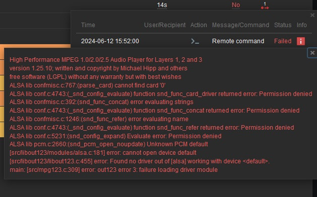

          Now I changed it such as follow :
          but when trigger fire status another failed with attached error
          Even I used follow command
          usermod -aG audio zabbix
            • 5004
            That looks like script (error) output... I guess your script was developed as root user, who has access everywhere and can do anything, then there was no errors... but now trying to run as normal user, it gives errors..
            I doubt I could say anything about it even if you show us the script content... You need to make it work as normal user ...

                • 5004
                Problem may be in some paths and environment vars missing. When you log on all kind of vars are set. Zabbix is not by default a login account so nothing like that is is set, you may need to add some of it to beginning of the script. But I fail to tell, what you need exactly..
