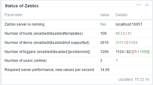

Please help. I have Zabbix 3.2 on centos 7 and watching 66 hosts. Servers are HP Proliant ML310 V2 gen8, ML30 gen9, DL 360 g7, dl 380 g7 and etc.
I am using SNMPv2 agent with OID for temp, hdd, nic, vent... and it works great but problem is that after sometime Agentless Management Service is down after some time on random servers. Then i have to log on ILO4 port and reset diagnostic to up the service and again. My trigger for snmp is nodata.
I put NIC to 100BaseT, Full-duplex. Reading OID is on 5 to 10 minutes but is the same problem. ILO4 firmware is 2.20 May 20 2015.
Please is someone have some idea.
Thank you.
