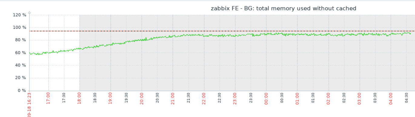

              Hello
              I have Zabbix version 6.0.21 , i downloaded Kubernetes Templates (Kubernetes API server by HTTP, Kubernetes cluster state by HTTP, Kubernetes Kubelet by HTTP, Kubernetes nodes by HTTP and Kubernetes Scheduler by HTTP) and assign them to Kuebrnetes host, when i enable it it leads to memory leak as shown below - Please check advise :
