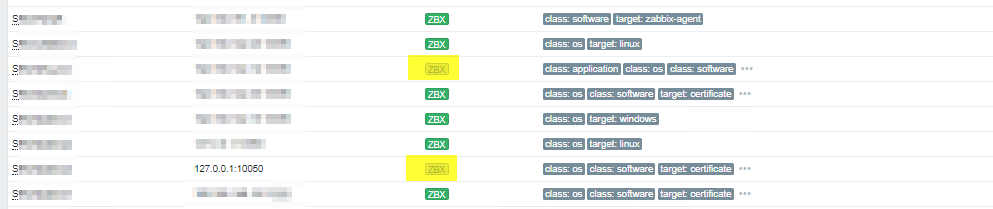

                Since yesterday and the update of Zabbix server to 7.0.1, I have random Active Checks also not working.
                My setup was working fine with 7.0.0 since weeks (I almost updated straight away)
                Reboot of the server seems to solve for some the issue but others are coming. Since last reboot, the server itself is not capable to have Active Checks:
                Click image for larger version  Name:	image.png Views:	0 Size:	23.9 KB ID:	488076
                Update of agent to 7.0.1 doesn't not solve the issue (I tried on a couple of VMs and Zabbix host is updated already)
                It's my own home lab, so I don't bother too much, but this version have surely problems.
                Most of my VMs are connected to Zabbix server since at least a year and I never had such connectivity issues prior yesterday (most VMs on same subnet)
                Kind regards
                Franck
