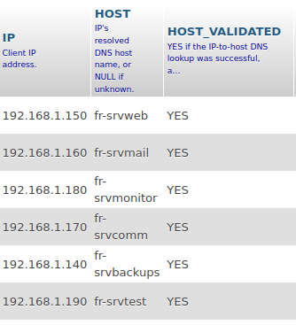

                  Screenshot of host_cache table:
Name:	Capture d’écran du 2024-07-22 18-16-41.png
                  Zabbix server name is fr-srvmonitor.

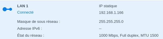

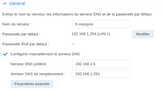

                  Originally posted by Markku
                  - MariaDB server IP address+netmask and DNS resolver address(es)
Name:	Capture d’écran du 2024-07-22 18-21-22.png

                      Content of host_cache table:
                      IP                     HOST                     HOST_VALIDATED
                      192.168.1.150      fr-srvweb           YES
                      192.168.1.160      fr-srvmail           YES
                      192.168.1.180      fr-srvmonitor      YES
                      192.168.1.170      fr-srvcomm        YES
                      192.168.1.140      fr-srvbackups     YES
                      192.168.1.190      fr-srvtest            YES
                      ==> All my servers
                      IP : 192.168.1.166
                      Netmask : 255.255.255.0
                      Gateway : 192.168.1.254
                      DNS : 192.168.1.5

                            First test:
                            only "zabbix"@"fr-srvmonitor", flush privileges, flush hosts ==> host_cache: 192.168.1.180 fr-srvmonitor YES
                            Second test:
                            only "zabbix"@"192.168.1.180", flush privileges, flush hosts ==> host_cache: 192.168.1.180 fr-srvmonitor YES
                            Rejected connections for both.
