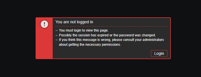

    Hello! I have an issue with zabbix, I´m implemented this 1 month ago, and few days ago started to fail the web interface with a pop up like this.
    Click image for larger version  Name:	image.png Views:	14 Size:	13.8 KB ID:	487800
    So I see some topics and made some change in the server, the vm is an ubuntu 24.04 and have mysql for database, have 2 cpu, 8GB Ram, and 200GB to storage. I change the memory_limit to 128M to 64M, and i give permision to read to other users. Thanks for the help!
