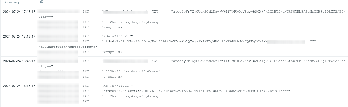

    I want a trigger that fires when TXT records for a monitored domain are changed. Unfortunately, Zabbix collects this data in some scrambled way
    so the trigger fires almost every time the item is polled. Polled every 30m, it has come back with a different result 35 times out of the last 48 :-(
