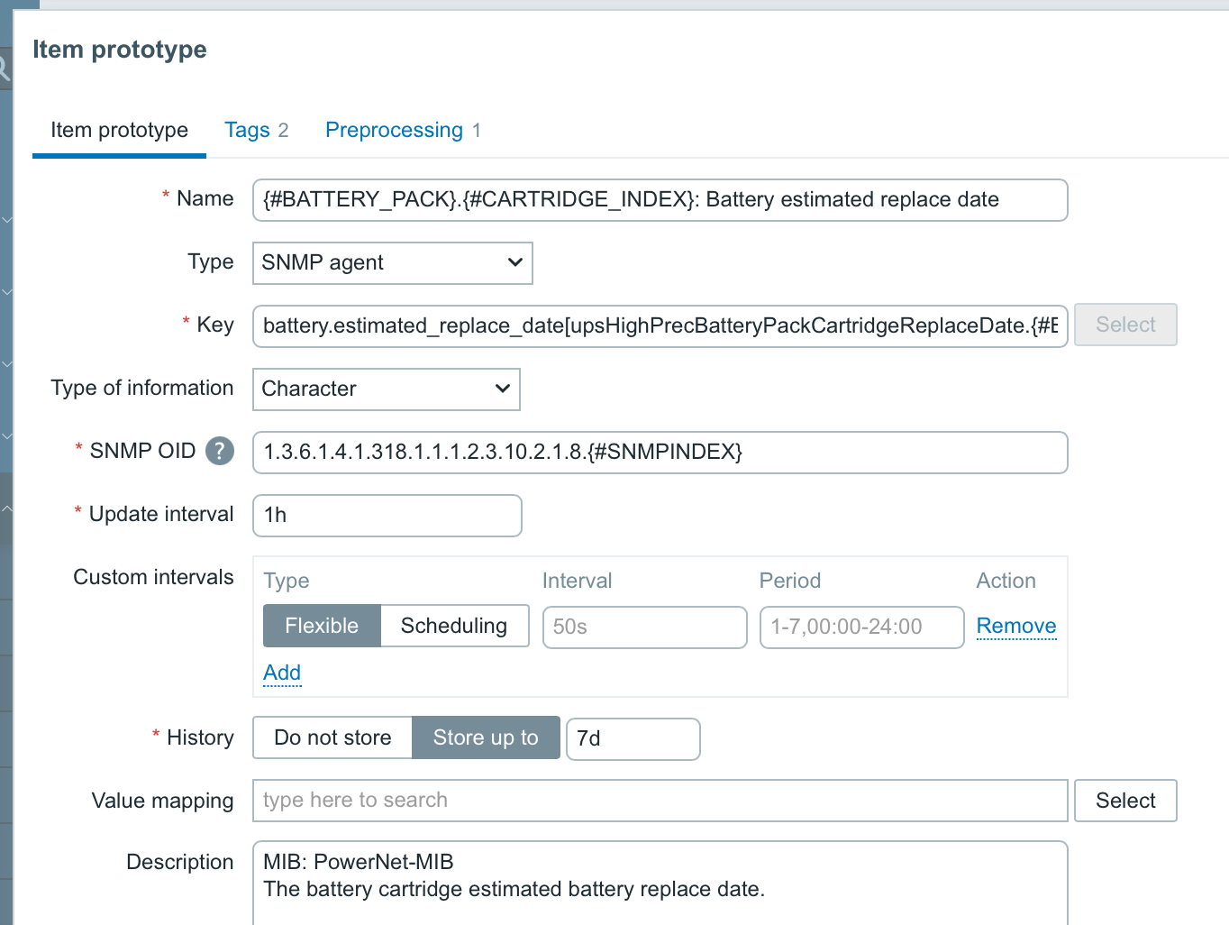

        So we are talking about this item prototype:
        1.3.6.1.4.1.318.1.1.1.2.3.10.2.1.8.{#SNMPINDEX}
        and the only preprocessing rule is discard unchanged. So that OID contains the date as string.
        Markku
          • 5004
          upsHighPrecBatteryPackCartridgeReplaceDate and upsHighPrecBatteryPackCartridgeHealth are 2 different OID-s... (...2.1.8 and ...2.1.7 respectively...). One returns health bitmap, other one date... So you cannot really use regex from bitmap to apply to date...
          I suppose if that date returns some obscure value from year 2020, it might be some default value and not set to something meaningful. So basically useless...
